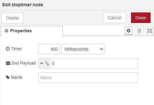

Also, I had an issue with the button presses sometimes sending 2 payloads immediately, so was causing an issue because I wanted to use single press to toggle light on and off. It would turn the light on and then immediately off when the 2 payloads were sent. I didn’t want to waste the double click on the off command so I found that adding a 400 millisecond stop timer fixed the issue.

Can you post how you did your stop timer?

Love the idea of long hold on the aqara switch for increasing brightness. I’m going to play around with that this week. Anyway here is the screenshot of the stop-timer. I didn’t try any less than 400 milliseconds but less than half a second response has been great.
