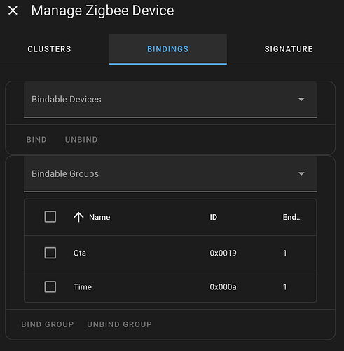

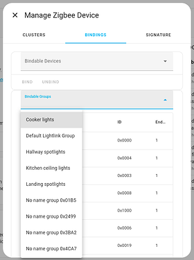

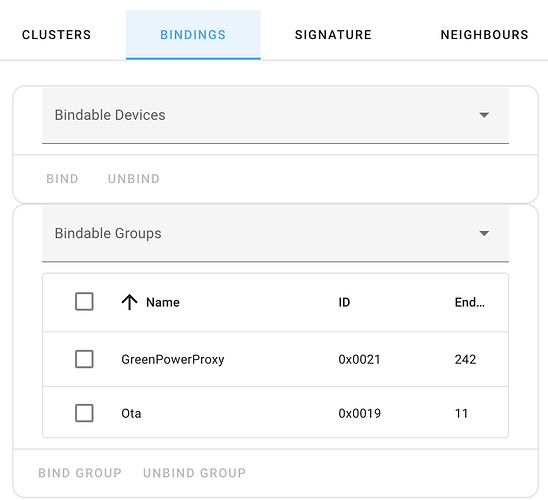

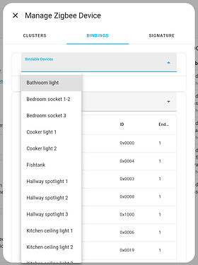

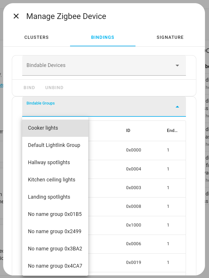

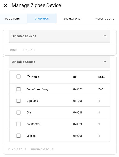

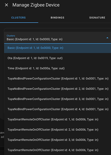

Trying to figure out the bindings/group function for my large Zigbee network.
It would seem that all of my devices only have very limited cluster control and not the on/off or LevelControl clusters needing for directly pairing a remote with a switch/light
Is this just because none of my devices support it or is it a problem with my setup? (Sonoff Zigbee 3.0 USB Plus)
(Hue bulb LWA004 by Signify Netherlands B.V.)
(Tradfri Control Outlet)
Here is the diagnostics:
