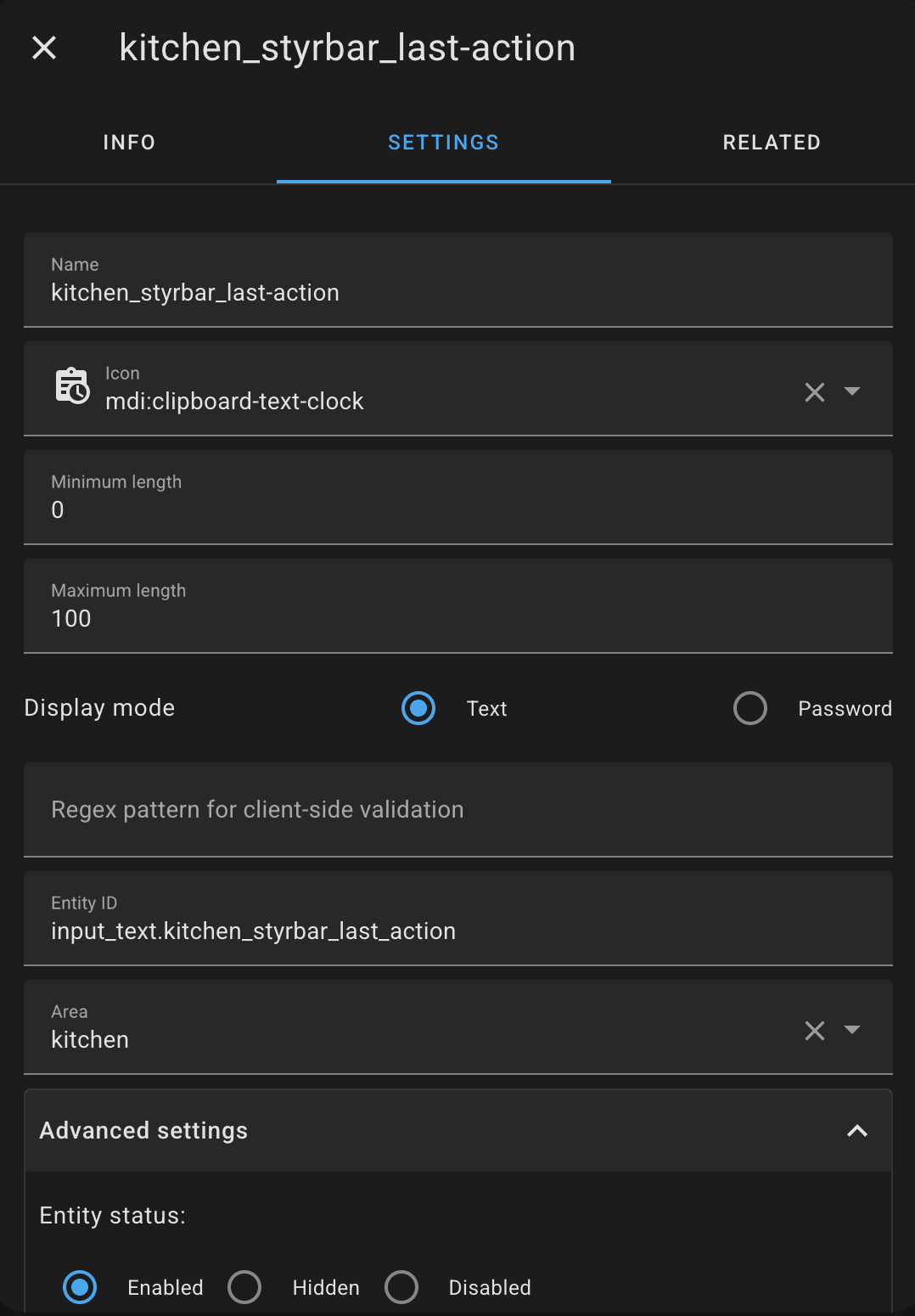

Is this helper entity setup correctly?
Also I did not figure out how to combine the hook with the blueprint. I could get the hook working but then it was using like a standard mapping of the controller, however I want to map the buttons myself.
The hook offers some nice functionality like the smooth turn on though, which I would love to use with the blueprint. I am a bit confused why one would need both the hook and blueprint, for me it seems they replace each other?
I’ve no experience with Zigbee2MQTT, I can’t speak for the configuration of that side.
Your helper looks fine though.
