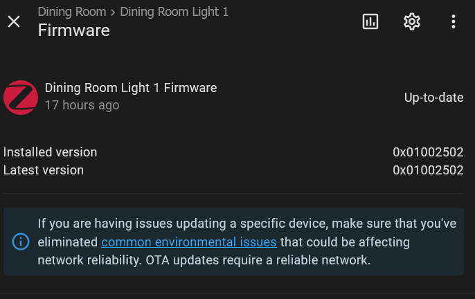

Wow, I did this last night and 36 updates were found for Philips Hue downlights, motion sensors, Tap Dial Switch and contact sensors, Clipsal Wiser light switches and my Aqara Roller Shade Driver.
Thanks for sharing.
Is there any way to map the firmware versions shown by ZHA to the manufacturer versions?
For example, the firmware versions for Philips Hue Lights - https://www.philips-hue.com/en-us/support/release-notes/lamps - don’t look anything like what is shown in ZHA:
Another round of Philips Hue firmware upgrades came through yesterday evening but only for lights, not accessories.
Without some sort of correlation between the official Philips Hue version numbers and those displayed by ZHA, it’s impossible to know what has been added/changed.
