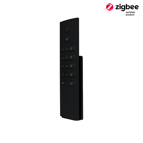

I have created a blueprint for the iCasa Black Remote (Smart Dimmer) based on the Zigbee Home Automation (ZHA) integration. As an example I have used an old blueprint (April 2021) by masteriiz which was not working anymore. I assume that changes have been made to the ZHA integration since 2021.
The device seems the same as the “ROBB SMARRT Draadloze Afstandsbediening 4 Kanaals Zigbee” but I have not been enable to test this.
The blueprint handles all individual buttons (1-4 Off and On) and the Scene buttons S1 and S2. Both short and long press events are handled for these buttons.
The Main On and Off buttons are not handled separately since they fire off the (4) events of each of the individual buttons.
For a further explanation see the description of the blueprint.
Features:
  • Simplified configuration for dimming of lights. No need to configure the individual events. Just assign the 4 lights (or group of lights) to be operated (turn off, on and dim) and you are good to go.
  • Configurable actions for the Short Press (Recall) Events of the Scene Buttons (S1 and S2).
  • Optionally: Configurable actions for each of the Events (Off, On, Dim Down and Up and Release) of the individual buttons (1-4). Only applicable when no light is assigned to the button.
  • Dimming of lights is supported by repeating the assigned action for the Long (minimum 2 seconds) Press (Dim Up and Down) events of the buttons (1-4). The repeat is automatically interrupted when the button is released and the dimming will stop.
  • Number of maximum repeats (when not interrupted) is configurable but first try the default of 20.
  • Delay between the repeating (dim) actions is configurable. This allows you to increase or decrease the dimming speed.
  • Long (minimum 4 seconds) Press (Store) events of the Scene buttons can be assigned a separate action (e.g. 2 other scenes) .
The preferred way of configuring is just to select 4 lights to be operated but alternatively you can assign the actions for your Lights and Scenes per button event:
  • Button (1-4) Short Press Off: Assign an action to Turn Off a Light.
  • Button (1-4) Short Press On: Assign an action to Turn On a Light.
  • Button (1-4) Long Press Off: Assign an action to Turn On the Light with a negative brightness step percentage (for example step of -10%).
  • Button (1-4) Long Press On: Assign an action to Turn On the Light with a positive brightness step percentage (for example step of 10%).
  • Button (1-4) Long Press Release (On and Off): No action required!
  • Button S1 and S2 Short Press: Assign an action to Activate two Scenes.
  • Button S1 and S2 Long Press: Assign an action to Activate two other Scenes.
