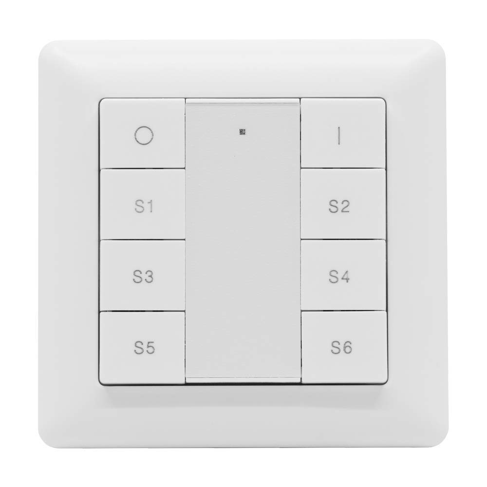

ZHA - icasa Pulse S8 Keypad remote
This is a blueprint for the icasa Pulse S8 Keypad remote, specifically for use with ZHA.
Available Actions (10 Actions):
  • Short press On-Button
  • Long press On-Button
  • Short press Off-Button
  • Long press Off-Button
  • Short Press on Button S1
  • Long Press on Button S1
  • Short Press on Button S2
  • Long Press on Button S2
  • Short Press on Button S3
  • Long Press on Button S3
  • Short Press on Button S4
  • Long Press on Button S4
  • Short Press on Button S5
  • Long Press on Button S5
  • Short Press on Button S6
  • Long Press on Button S6
