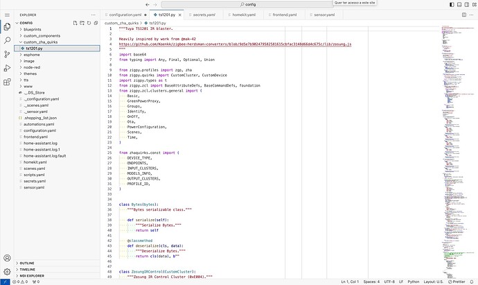

Hello, I made the adaptation, put it in, created the folder and put the file inside it, which was passed through the website, through git, but I don’t know what to do now, how can I configure it to copy the signals. Would you help me? I am a beginner. Thank you very much.
Sorry, I haven’t had time to look at this again. But I learned how to capture remote IR codes from the linked documents.
Do you mean you’ve installed the quirk? The device info page should look like this:
So here’s my configuration file that I imported, the Python script there, and there is also the about the entity that is not the same as yours.
Have you restarted HA?
Yes, I did a hard reset on Home Assistant. Should I re-adopt the device to make the changes or not? Or is it another problem?
Yes, try re-pairing.
I tried to repair the device again, but it didn’t work. It didn’t show the part that it had to show.
Take out the batteries for a minute or two first, then re-pair?
