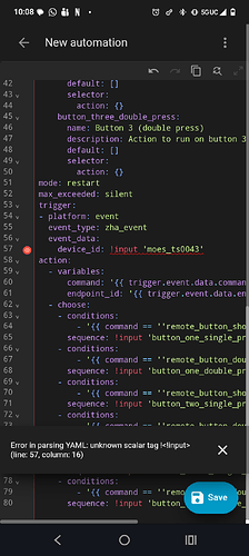

I was able to get this working on my switch with just a slight modification to the OP. My switch has a different “manufacturer” field than OP and so the switch wasn’t showing up in the blueprint. I pulled up the device info and the manufacturer was listed in there (_TZ3000_1kmurvlx) and so I just updated that.
I also had to fiddle with “how do I make a new blueprint?” since I hadn’t done that before…
I get this error when I copy the OP’s blueprint with your manufacturer id (i have the same one). Any ideas?
UPDATE: my bad… I’m an idiot! I was adding the YAML to the automation. I had to create a YAML file and save it in the blueprints folder for the automations to pick it up. It’s now working flawlessly!
After my booboo above, I was able to make the blueprint work. I also added support for long press. Everything should work after copy/pasting the code. If it doesn’t make sure the manufacturer id matches your device.
If you’re not sure where to add this (like I was), install a text editor to your Home Assistant, something like VS Code or File Editor. Go to config → blueprints → automations → moes . If moes doesn’t exist, create the folder. Inside the moes folder, create a file and name it something like ts0043_3_button.yaml, and paste the code below. That should load the blueprint into your home assistant for you to pick from automations. If you make edits to the yaml file later, go to Settings → Tools and restart automations every time you make one.

trigger:
- platform: event
  event_type: zha_event
  event_data:
    device_id: !input 'moes_ts0043'
action:
  - variables:
      command: '{{ trigger.event.data.command }}'
      endpoint_id: '{{ trigger.event.data.endpoint_id }}'
  - choose:
    - conditions:
        - '{{ command == ''remote_button_short_press'' and endpoint_id == 1 }}'
      sequence: !input 'button_one_single_press'
    - conditions:
        - '{{ command == ''remote_button_double_press'' and endpoint_id == 1 }}'
      sequence: !input 'button_one_double_press'
    - conditions:
        - '{{ command == ''remote_button_long_press'' and endpoint_id == 1 }}'
      sequence: !input 'button_one_long_press'
    - conditions:
        - '{{ command == ''remote_button_short_press'' and endpoint_id == 2 }}'
      sequence: !input 'button_two_single_press'
    - conditions:
        - '{{ command == ''remote_button_double_press'' and endpoint_id == 2 }}'
      sequence: !input 'button_two_double_press'
    - conditions:
        - '{{ command == ''remote_button_long_press'' and endpoint_id == 3 }}'
      sequence: !input 'button_two_long_press'
    - conditions:
        - '{{ command == ''remote_button_short_press'' and endpoint_id == 3 }}'
      sequence: !input 'button_three_single_press'
    - conditions:
        - '{{ command == ''remote_button_double_press'' and endpoint_id == 3 }}'
      sequence: !input 'button_three_double_press'
    - conditions:
      sequence: !input 'button_three_long_press'
