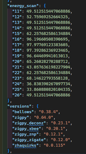

I was actually not aware of channel usage, thanks! Yeah I can see that it’s looking pretty cramped, I’m in an apartment block so I’d imagine this is expected?
Is there something I can do here to optimise the channels I’m using, or is that down to the devices I purchase? Would this also be a risky thing to change if I were to look down this route?

All your channels look quite noisy - you’re right, typical apartment block - so I don’t think that would help much, but for reference, it’s done in ZHA and your devices should follow the coordinator to the new channel you set.

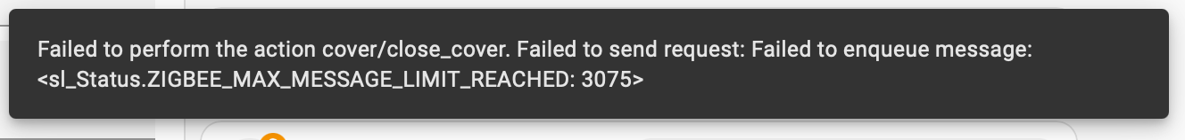

I’ve also just started having a problem with my zigbee addon. I get this error message every few days.
I only have 3 devices, 2 Graywind window Blinds and the 3rd is a Generic Zigbee Coordinator (EZSP).
The dongle is a SONOFF Universal Zigbee 3.0 USB Dongle, plugged into a Dell thin client.
The system has run without problem since June this year.
Have enabled debugging but haven’t found the file yet.
Still having the same issue,
I have wrote a automation to restart HA every day at 02.00 which stops the error occurring, but its a bodge and I would prefer a proper fix.
has anyone any ideas about this error and how to stop it?
