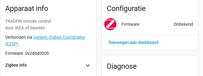

All devices are saying : Firmware - Unknown :

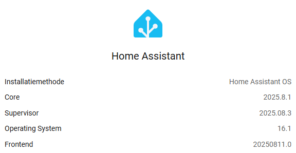

Home Assistant version :

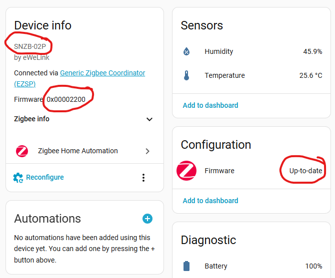

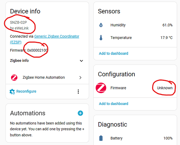

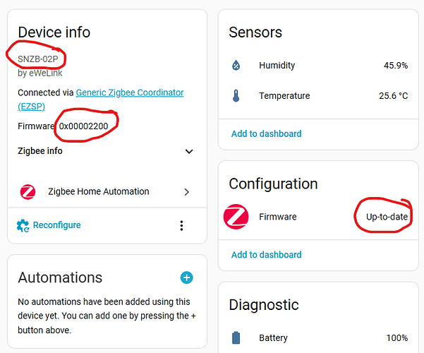

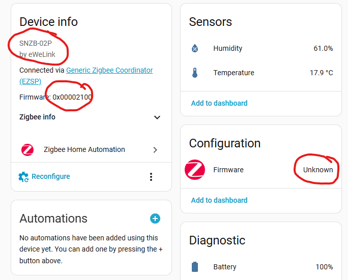

I have 3 Sonoff temperature sensors, SNZB-02P. I bought them as a 3-pack.
Today, ZHA suddenly found a firmware update for one of them, it downloaded and installed fine. My other sensor, identical, however still says Firmware Unkown many hours after updateing the first one.
How can ZHA find a firmware update for one of them but not for another one?
