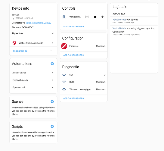

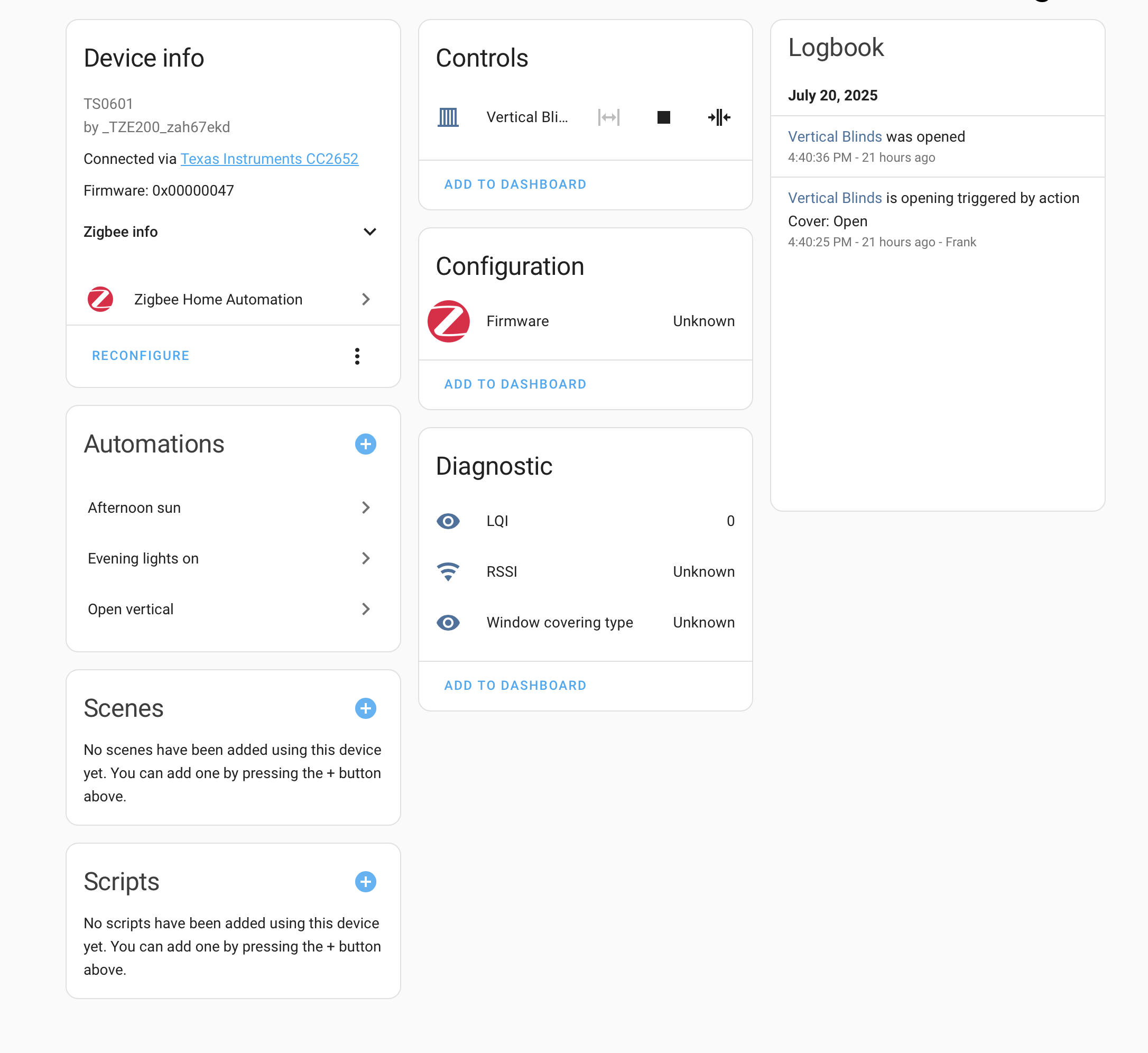

Hello - is this still capable/relevant at:
Installation method
Home Assistant OS
Core
2025.7.2
Supervisor
2025.07.1
Operating System
16.0
Frontend
20250702.2
I have several of these devices with unknown firmware statuses:
Thanks!
