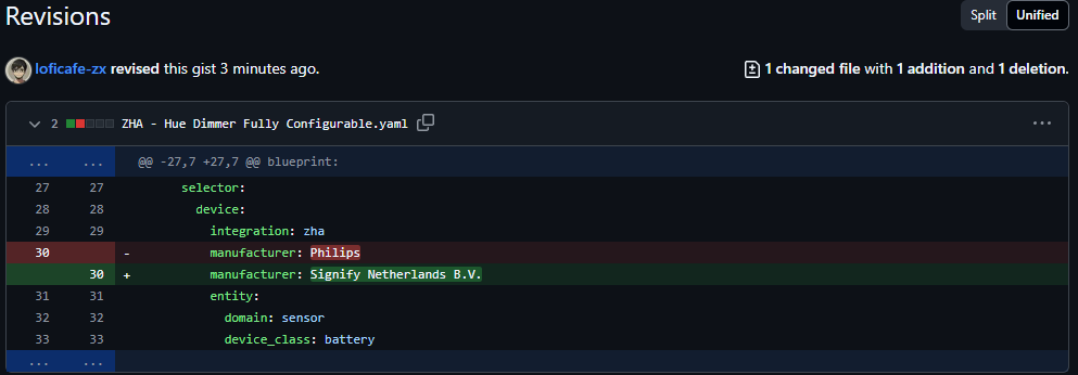

Have updated the gist/blueprint to reflect this.
@Sjorsa @kdzoha @tgferreira @kraeg Re-import your blueprint to get the update. Please let me know if this fixed your issue as well.

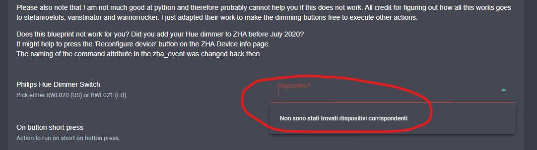

If I try to use this project I can’t connect the device. Home Assistant tells me that there is no device of this type available. In Home Assistant the device is present but it is not recognized in the projects. What can I do?
I noticed that the device manufacturer is listed as Signify Netherlands B.V. instead of Philips. That was the issue I encountered. Feel free to use my fork if you’re experiencing the same problem. ZHA - Hue Dimmer Fully Configurable.yaml · GitHub
Thanks! Solved the issue @flavio61 has for me
