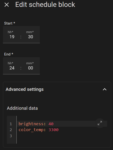

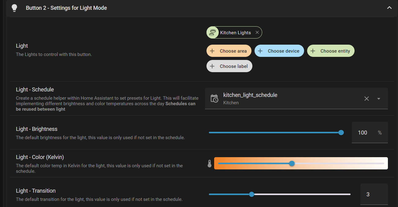

Hi @danieldeni - I’ve been using your Blueprint for a while now but I think I have run into an issue with using a Schedule.
My Hue downlights are switched my Clipsal Wiser switches so I have an automation that keeps the light state and switch state in sync but also using different light settings (brightness, colour temp) depending on the time of day.

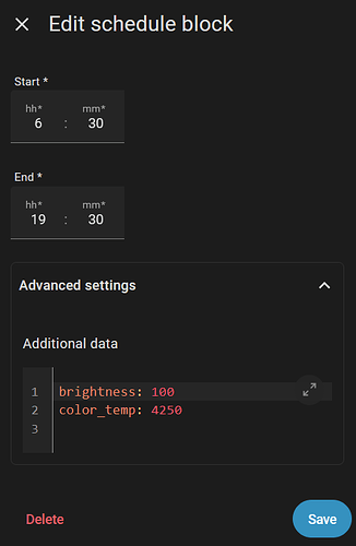

I replicated those time of day settings in a Schedule, created via the UI:
I have added that Schedule to the automation created from the Blueprint, however the Blueprint seems to be ignoring the Schedule:
When I use Button 2 after 19:30, the lights come on using the settings in the Blueprint rather than what is specified in the Schedule.
Check the example I have in the start post. The additional data should be with these names per field:
brightness_pct: 30
color_temp_kelvin: 3333
Where you can put your own numbers of course, per preference.
Do keep in mind the Blueprint doesn’t trigger the schedules automatically on changes, only if you press the button. I have a separate automation in place that triggers on schedule change, might integrate that later into the blueprint.
I’ll try that out, thank you.

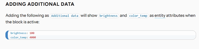

Note though that the documentation for Schedules - https://www.home-assistant.io/integrations/schedule/#adding-additional-data - show the formatting as I have it:
That’s an example for generic use yes. And might be updated in the future outside of my control.
color_temp was linked to mired in the past and was changed somewhere in 2024 to be based on kelvin. To avoid confusion I used color_temp_kelvin .
My start post has instructions for my blueprint specifically. You can use whichever names are set inside the blueprint, others are ignored as they are not put in the logic of the automations and variables.
Now working as expected. Thank you.
