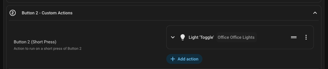

In the end, it should probably look very similar to what I posted in the screenshot. Hoep this helps.

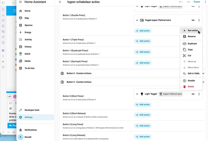

thanks, I will try to find what I can for that. An other thing I noticed, the toggle from a double tap does work. Just not from the single tap. BTW: the lamp is a Hue so that should not be a problem.
Also, when I use ‘Run action’ the toggle also works as expected.
That’s the UI for the other blueprint, not this one.
Button 3 Short Press shows “Light Toggle” and then a second item turning a light off. That’s not right. Fix it so it looks the same as Button 1 Double Press, which you know is working.
