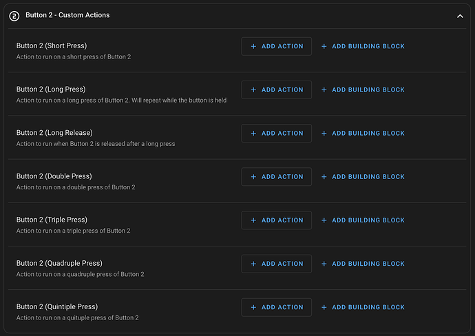

This is how the blueprint supports configuring custom actions. This is for “Button 2” for which all custom actions are available. Buttons 1, 2, and 4 don’t have options for short presses since those are dedicated to Play/Pause, Previous Track, and Next Track:

Hi, thanks so much for the brilliant blueprint! I don’t know if I’m doing anything wrong but when I set up the automation to toggle a light, or group of lights, it does not work when I press the button on the tap device but the automation does run if I activate it manually in the home assistant app.
The button press is correctly registered in the log:
tap Remote Button Short Release - Button 4 event was fired
And
Is there anything I’m doing wrong or is that toggle action not possible?
Hi, @space-dementia.
This blueprint has pre-defined behaviors for presses of buttons 1 (play/pause), 3 (prev track), and 4 (next track).
It doesn’t allow the user to specify a behavior for a simple press of button 4. If you look at the blueprint section for button 4, you’ll note that you can only set the behaviors for a long press, double press, triple press, quintuple press.
So it may be that you have set up an automation for a long press but you’re expecting it to run on a short press.
One way to figure this out is to edit the blueprint and select the three dots in the upper right corner and choose “Edit in YAML”. You’ll be able to see clearly how your automation is configured.
This blueprint is intended primarly for people who want to use the controller to control a media player. That’s why it reserves the actions of simple presses of 1, 3, 4. If you want full customization of the controller, including being able to make a short press of any button do whatever you want, then the other blueprint I created for this controller may be a better choice. It’s here:
Hope this helps.
