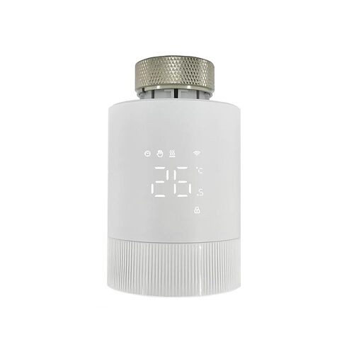

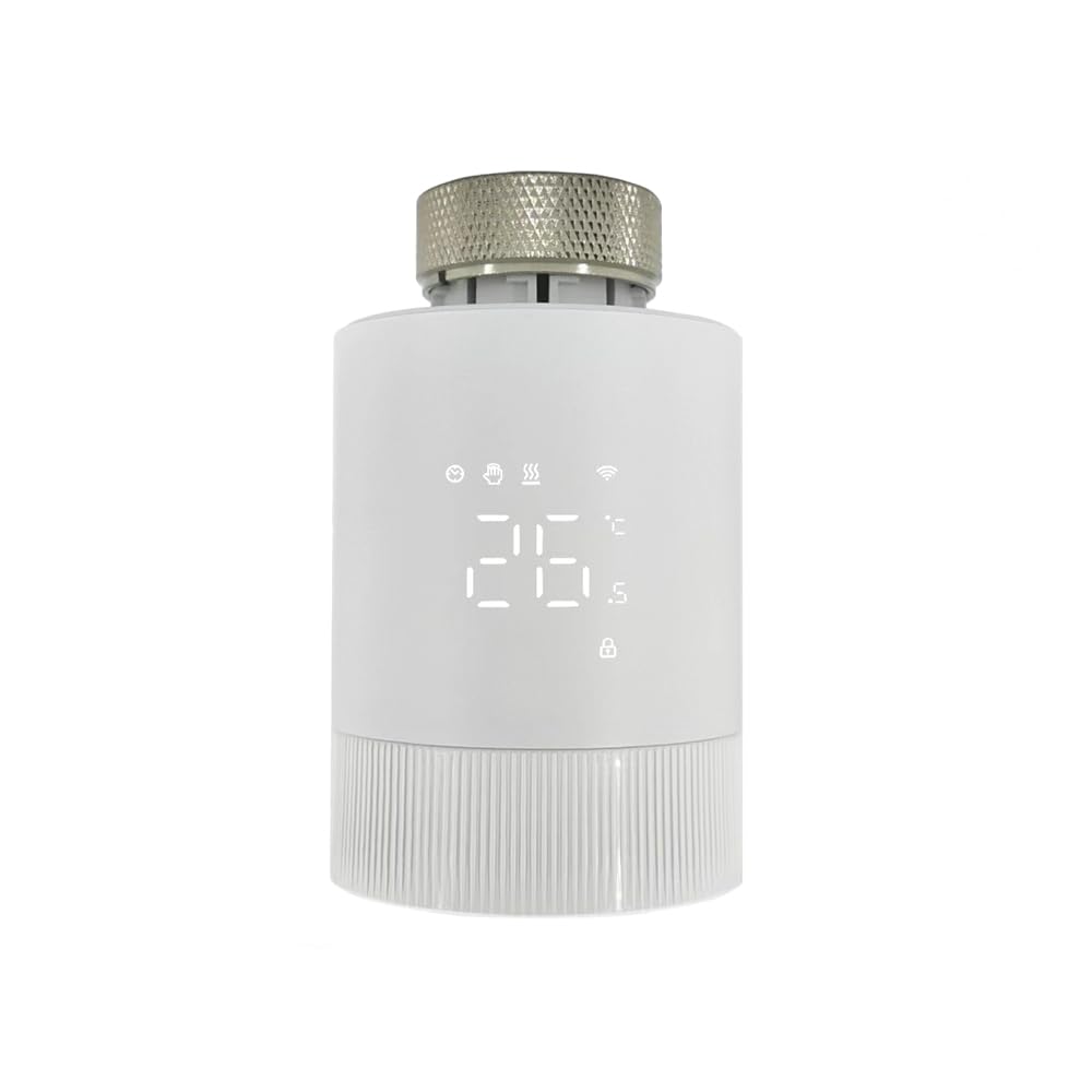

Hello everyone! Recently bought Zigbee thermostats from Tuya (photo):
It is defined in ZHA as TS0601 _TZE204_eekpf0ft

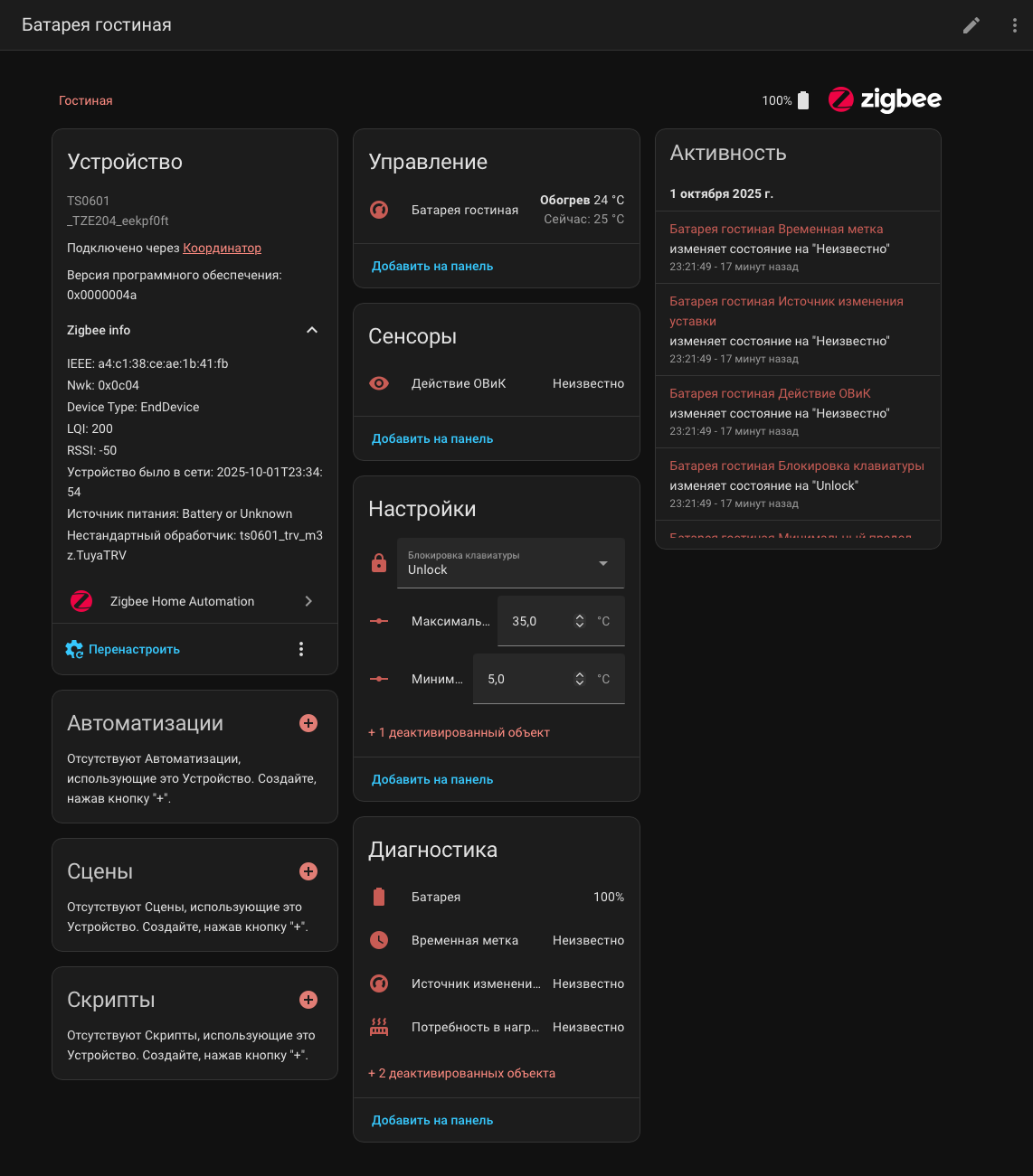

I’m still figuring out how to create a quirk for ZHA. So far, I’ve managed to get the device’s basic functions working. At this stage, I can turn the heating on/off and select the temperature. The battery status display also works correctly. I haven’t tested the threshold settings yet.
Also, here’s a quirk code based on this: [Github]: zha-device-handlers/zhaquirks/tuya/ts0601_trv_tze204.py at 94e15bdcdeeab9dc333fbd587416bffd1b76048f · Teka101/zha-device-handlers · GitHub

Just tested, for _TZE204_vjpaih9f this seems to also work after adding the signature.
Hello!
Just get almost the same device TS0601 by _TZE284_eekpf0ft
Tryed to add signature in quirk signature
MODELS_INFO: [
(“_TZE284_eekpf0ft”, “TS0601”),
But with no luck( device still is unrecognized, and “custom quirk” under zigbee info didnt shown. What am i doing wrong?
Приветствую! Такая же железка, но модель TZE284. Отредактировал сигнатуру, но никак не хочет подцеплять кастомный квирк( в зигби инфо не появляется строчка о том, что используется кастомный квирк
@Starlex88 I’ve got a quirk working for exactly this model (“_TZE284_eekpf0ft”, “TS0601”). Only HVAC and setpoints so far.
Look at https://github.com/zigpy/zha-device-handlers/issues/4525
