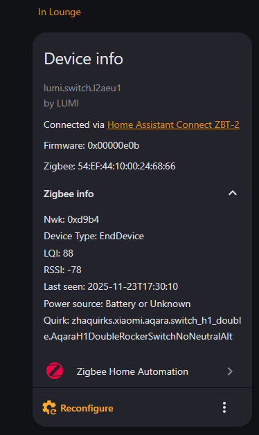

I saw on another forum that sometimes the quirk isn’t being applied properly. Mine certainly wasn’t. I disjoined the device (removed it) and re-joined it and all of a sudden, the quirk was properly applied and I could see the “OppleSwitchCluster” which is the cluster which apparently lets you set the mode to decoupled (so it doesn’t activate the relay). Alas this process is hit and miss, mostly miss.
For example, this one worked after re-joining:

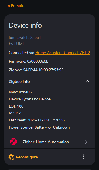

I’ve tried re-joining this one 4 times, same result (no quirk applied).
