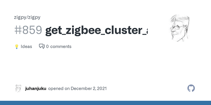

I try to rise this idea in GitHub

I have been using the solution from @antoineDion for more than a year. Its listed here - https://github.com/home-assistant/core/issues/44032.
It breaks once in a while when the ZHA component is updated, but then I just readd the tweaks as a ZHA_custom-component and voila - back in business. I then read the attribute using an automation.
Can you please add the feature developed in this issue? zha.READ_zigbee_cluster_attribute · Issue #44032 · home-assistant/core · GitHub
