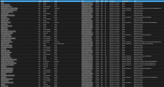

I’ve been monitoring the devices using the awesome zha-network-card and have seen devices going offline. Some come back by pressing reconfigure device, others seem to need to be reset and included again.
I also noticed that none of my devices are reporting an RSSI value. All of them did with the ConBee II. Assuming the Sonoff coordinator is also capable of reporting RSSI, how do I fix this?

as for the rssi, none of the texas instrument usb coordinators have them
Ah, great, it helps to know there isn’t some bug/issue with my setup. One less thing to worry about. I guess LQI should be enough to just the health of the link.
