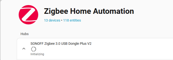

ZHA Sonoff Zigbee 3.0 USB Dongle Plus V2 randomly stuck in “Initializing”
I’m facing a recurring issue with ZHA and I’m trying to properly debug it instead of just working around it.
My ZHA Sonoff Zigbee 3.0 USB Dongle Plus V2 is getting stuck on “Initializing” randomly about once a week after a HomeAssistant update, a few months back.
Problem:
Dongle works fine for days, then randomly goes to “Initializing” so all Zigbee devices stop working

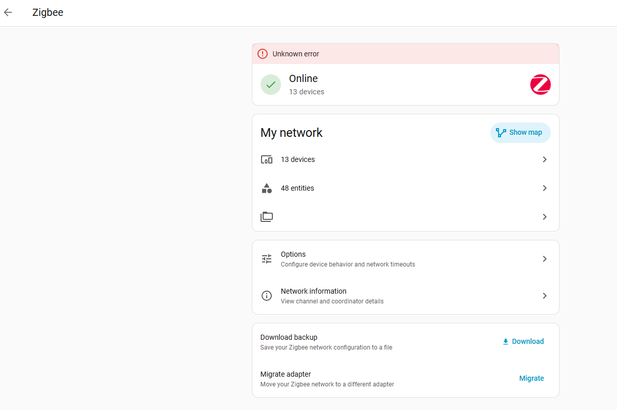

I enabled debug logging and captured the moment it died. Here’s what the log shows:
Everything was running normally: readCounters / getValue commands were succeeding every ~10 seconds, free buffers were stable at 249, no ASH framing errors, no overruns, no obvious timeouts.
At 2026-05-02 10:03:56 ZHA suddenly crashed with:textValueError: No gateway object exists to retrieve the config entry from.Right after that the coordinator disappears completely (“Unknown error”, 0 devices, “Initializing”).
