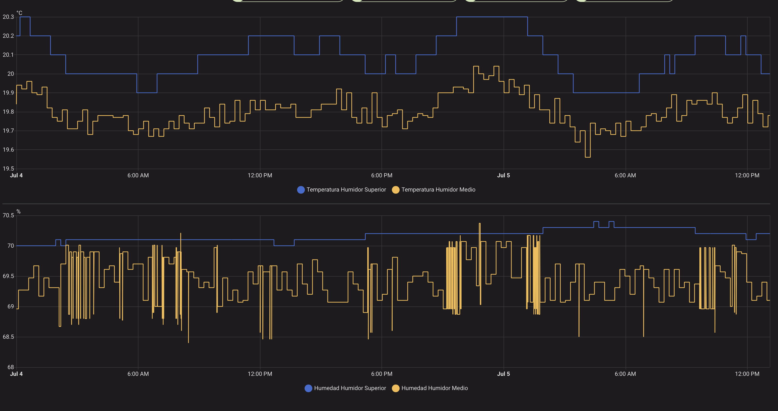

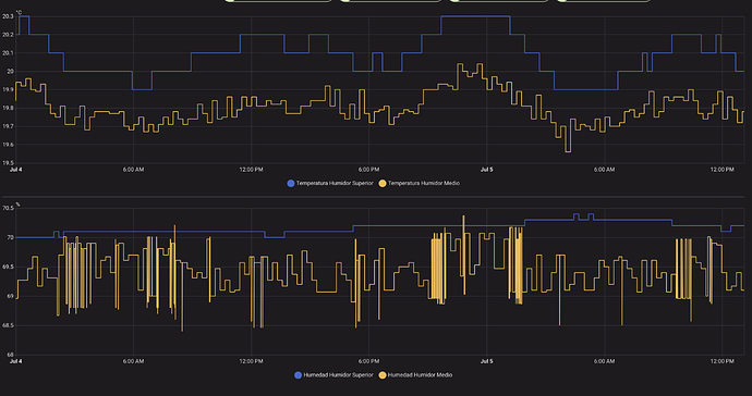

SNZB-02P is sold as improved version regarding power consumption, looks like what the just did is to put it to sleep more time than previous version SNZB-02.
In the picture blue line is SNZB-02P and yellow is SNZB-02 in same place of my humidor.
Is not only refresh rate but precision has been reduced to one decimal only
