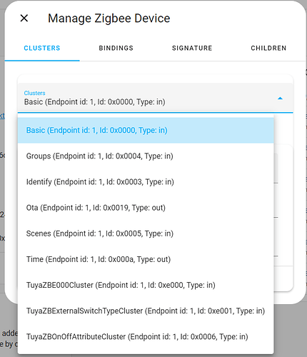

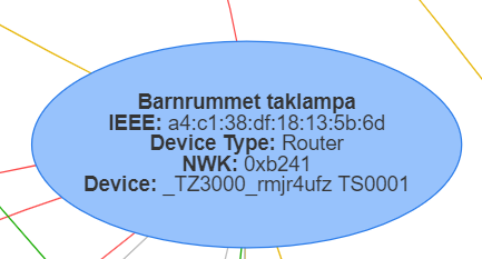

Device 1. HA\Integration\Devices\Device information
Device 1. ZHA\Visualization
Quirk applied;

4. Question
How can I mitigate this?
If there is a way, please describe the correct way to implement the suggested sollution.

    "manufacturer_code": 4417,
    "power_source": "Mains",
    "lqi": 255,
    "rssi": -67,
    "last_seen": "2022-10-16T17:41:07",
    "available": true,
    "device_type": "Router",
    "signature": {
      "node_descriptor": "NodeDescriptor(logical_type=<LogicalType.Router: 1>, complex_descriptor_available=0, user_descriptor_available=0, reserved=0, aps_flags=0, frequency_band=<FrequencyBand.Freq2400MHz: 8>, mac_capability_flags=<MACCapabilityFlags.AllocateAddress|RxOnWhenIdle|MainsPowered|FullFunctionDevice: 142>, manufacturer_code=4417, maximum_buffer_size=66, maximum_incoming_transfer_size=66, server_mask=10752, maximum_outgoing_transfer_size=66, descriptor_capability_field=<DescriptorCapability.NONE: 0>, *allocate_address=True, *is_alternate_pan_coordinator=False, *is_coordinator=False, *is_end_device=False, *is_full_function_device=True, *is_mains_powered=True, *is_receiver_on_when_idle=True, *is_router=True, *is_security_capable=False)",
      "endpoints": {
        "1": {
          "profile_id": 260,
          "device_type": "0x0100",
          "in_clusters": [
            "0x0000",
            "0x0003",
            "0x0004",
            "0x0005",
            "0x0006",
            "0xe000",
            "0xe001"
          "out_clusters": [
            "0x000a",
            "0x0019"
    "active_coordinator": false,
    "entities": [
        "entity_id": "button.barnrummet_taklampa_identifybutton",
        "name": "_TZ3000_rmjr4ufz TS0001"
        "entity_id": "light.barnrummet_taklampa",

    "user_given_name": "Barnrummet taklampa",
    "device_reg_id": "598f5e37a9c669158f811441304e67ba",
    "area_id": "barnrummet",
    "cluster_details": {
      "1": {
        "device_type": {
          "name": "ON_OFF_LIGHT",
          "id": 256
        "profile_id": 260,
        "in_clusters": {
          "0x0000": {
            "endpoint_attribute": "basic",
            "attributes": {
              "0x0000": {
                "attribute_name": "zcl_version",
                "value": 3
              "0x0001": {
                "attribute_name": "app_version",
                "value": 68
              "0x0004": {
                "attribute_name": "manufacturer",
                "value": "_TZ3000_rmjr4ufz"
              "0x0005": {
                "attribute_name": "model",
                "value": "TS0001"
              "0x0007": {
                "attribute_name": "power_source",
                "value": 1
              "0xfffe": {
                "attribute_name": "attr_reporting_status",
                "value": 0
            "unsupported_attributes": {}
          "0x0003": {
            "endpoint_attribute": "identify",
            "attributes": {},
          "0x0004": {
            "endpoint_attribute": "groups",
            "attributes": {},
          "0x0005": {
            "endpoint_attribute": "scenes",
            "attributes": {},
          "0x0006": {
            "endpoint_attribute": "on_off",
            "attributes": {
              "0x0000": {
                "attribute_name": "on_off",
                "value": 0
              "0x4001": {
                "attribute_name": "on_time",
                "value": 0
              "0x4002": {
                "attribute_name": "off_wait_time",
                "value": 0
              "0x8002": {
                "attribute_name": "power_on_state",
                "value": 2
              "0x4003": {
                "attribute_name": "start_up_on_off"
          "0xe000": {
            "endpoint_attribute": "tuya_is_pita_0",
            "attributes": {},
          "0xe001": {
            "endpoint_attribute": "tuya_external_switch_type",
            "attributes": {
              "0xd030": {
                "attribute_name": "external_switch_type",
                "value": 0
        "out_clusters": {
          "0x000a": {
            "endpoint_attribute": "time",
            "attributes": {},
          "0x0019": {
            "endpoint_attribute": "ota",
            "attributes": {},
device 2

This is the device info page under settings
Press the three buttons to access the menu for the device, and press “Manage zigbee device”
Look for “Endpoint id: ___”
In this case “1”
