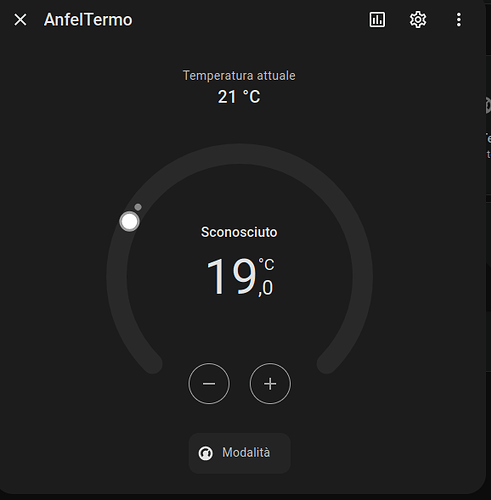

While connecting with TUYA integration and with the given zigbee2WiFi converter, the thermostat shows up as “Clima” entity with this view:
No HVAC option, but I can change the desired temperature witch is perfect to me.
Any idea to try before posting a new device integrartion request in GitHub?
