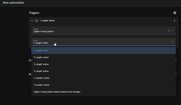

When I check the automation trigger, I get only 6 options as detailed below: 4 actions for single click and 2 actions for double click. Is there any way to get the remaining actions for double and long press?

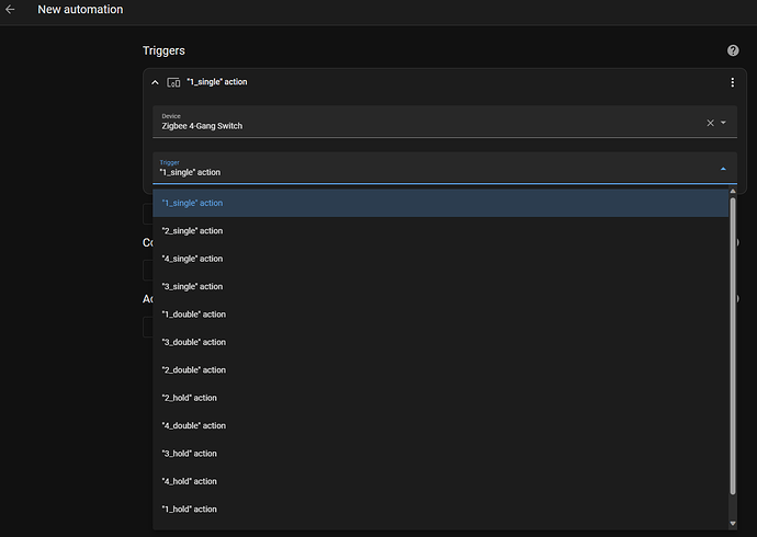

After looking at the “Actions (enum)” section of the page above, I’ve noticed that the available trigger options for this switch within HA’s Automation only displays the “single”, “double” and “hold” actions previously triggered on the switch. Now I can see all available options. Issue fixed.
Interesting. Wondering if those ‘seen’ values are retained by HA between HA reboots, would only matter for humans using the GUI automation builder I am thinking. Makes sense, as there is no ‘all possible values’ database/reference between independent systems such as Zigbee2MQTT and Home Assistant. Might be a ‘plus’ for ZHA over Zigbee2MQTT as ZHA and HA are much more tightly coupled. However, I think there are far more ‘pluses’ in the cap of Zigbee2MQTT over ZHA.
