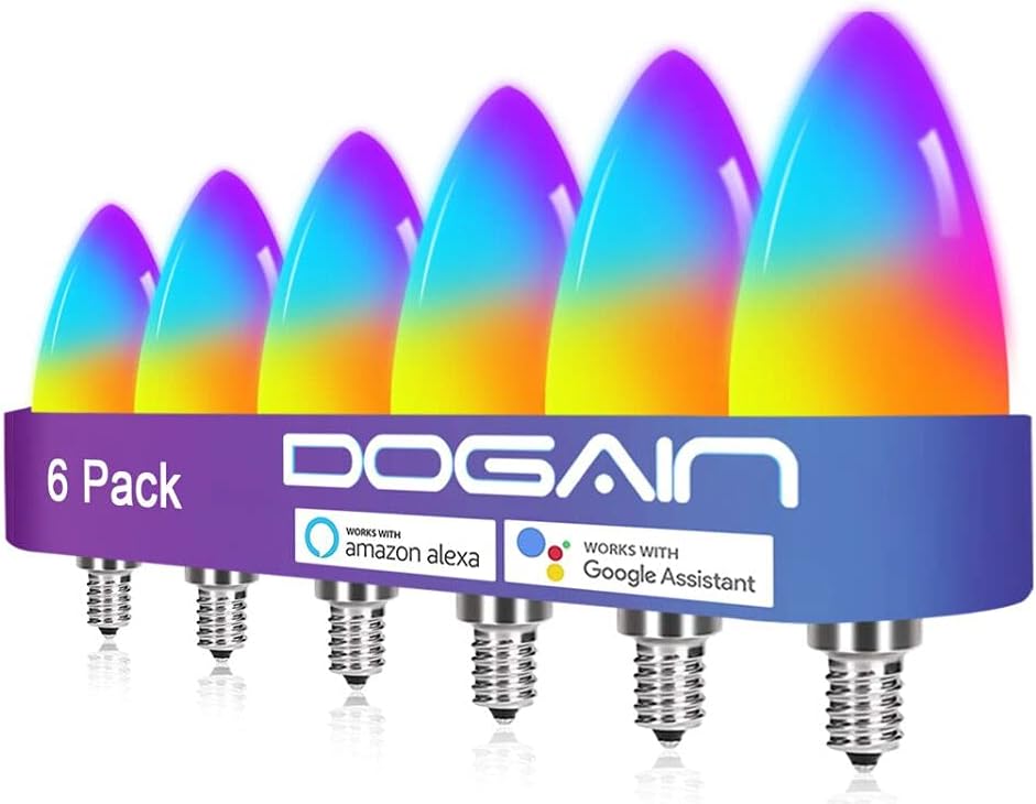

They are “DOGAIN Zigbee Smart Light Bulbs E12 Base B10/B11 Lights Color Changing Light Bulb”
Are these the ones you’re referring to:
I don’t see Matter support, but I’m interested if they work natively with home-assistant without 3rd party app?
