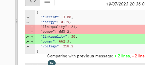

Using mqtt-explorer I see that the device is publishing but they don’t appear in home assistant. Someone could help me?
