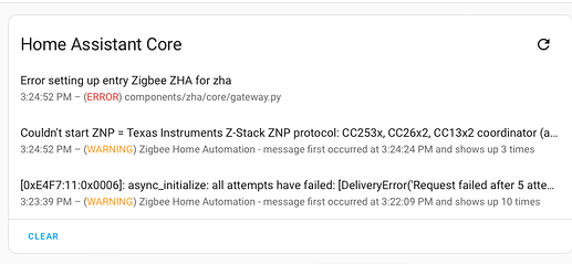

In my logs,
Error setting up entry Zigbee ZHA for zha
File "/usr/local/lib/python3.10/site-packages/zigpy_znp/api.py", line 665, in _skip_bootloader
result = await responses.get()
File "/usr/local/lib/python3.10/asyncio/queues.py", line 159, in get
await getter
asyncio.exceptions.CancelledError
Logger: homeassistant.components.zha.core.gateway
Source: components/zha/core/gateway.py:185
Integration: Zigbee Home Automation (documentation, issues)
First occurred: 3:24:24 PM (3 occurrences)
Last logged: 3:24:52 PM
Couldn't start ZNP = Texas Instruments Z-Stack ZNP protocol: CC253x, CC26x2, CC13x2 coordinator (attempt 1 of 3)
Couldn't start ZNP = Texas Instruments Z-Stack ZNP protocol: CC253x, CC26x2, CC13x2 coordinator (attempt 2 of 3)
Couldn't start ZNP = Texas Instruments Z-Stack ZNP protocol: CC253x, CC26x2, CC13x2 coordinator (attempt 3 of 3)
await getter
[0xE4F7:11:0x0006]: async_initialize: all attempts have failed: [DeliveryError('Request failed after 5 attempts: <Status.MAC_CHANNEL_ACCESS_FAILURE: 225>'), DeliveryError('Request failed after 5 attempts: <Status.MAC_NO_ACK: 233>'), DeliveryError('Request failed after 5 attempts: <Status.MAC_NO_ACK: 233>'), DeliveryError('Request failed after 5 attempts: <Status.MAC_NO_ACK: 233>')]
[0xE4F7:11:0x0300]: async_initialize: all attempts have failed: [DeliveryError('Request failed after 5 attempts: <Status.MAC_NO_ACK: 233>'), DeliveryError('Request failed after 5 attempts: <Status.MAC_NO_ACK: 233>'), DeliveryError('Request failed after 5 attempts: <Status.MAC_NO_ACK: 233>'), DeliveryError('Request failed after 5 attempts: <Status.NWK_INVALID_REQUEST: 194>')]
[0xBC0D:1:0x0202]: async_initialize: all attempts have failed: [TimeoutError(), TimeoutError(), TimeoutError(), TimeoutError()]
[0xBC0D:1:0x0008]: async_initialize: all attempts have failed: [TimeoutError(), TimeoutError(), TimeoutError(), TimeoutError()]
[0xBC0D:1:0x0006]: async_initialize: all attempts have failed: [TimeoutError(), TimeoutError(), TimeoutError(), TimeoutError()]
