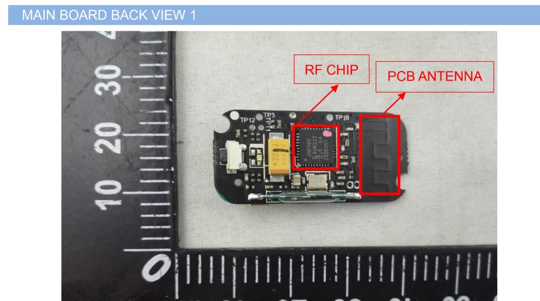

The Aqara MCCGQ11LM & MCCGQ12LM are still quite plentiful on the usual sites & relatively cheap depending on where you buy from.
Both have a reed switch, according to the FCC site pictures.
