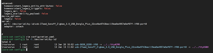

hi,
i have upgraded zigbee2mqq to version 2.0, and it stopped to work even i set the configs as advised
i am still getting error :

seems i was editing wrong configuration.yaml file, but now getting issue:
YAMLException: duplicated mapping key (112:1)
