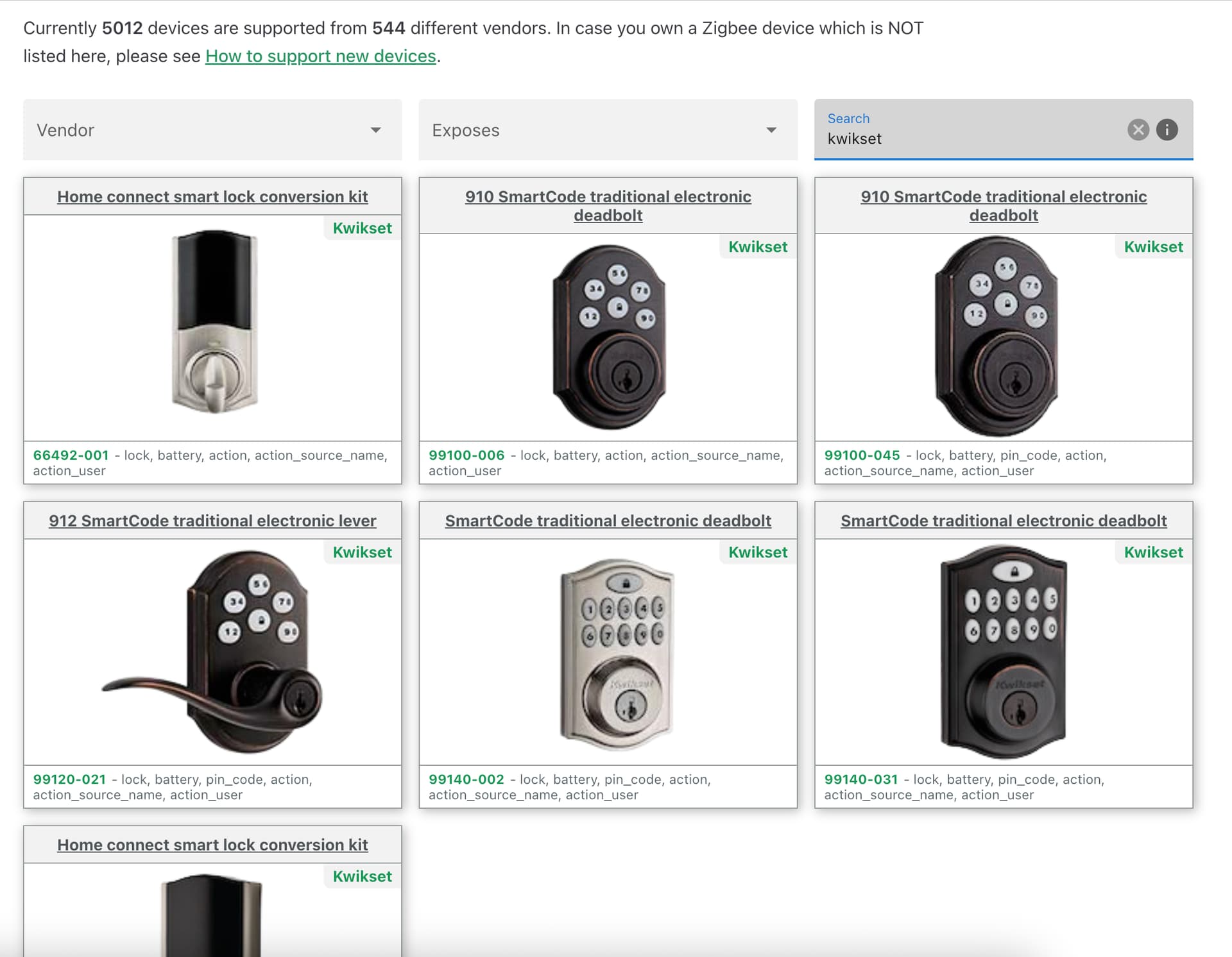

Is it on this list?
Thanks for sharing this compatibility list, I did not know about it before.
Interesting, it is not on this list directly but this one is similar Kwikset 66492-001 control via MQTT | Zigbee2MQTT.
But it is on ZHA’s list so maybe I go back to trying ZHA. Kwikset SmartCode Traditional Electronic Deadbolt 916TRL ZB Zigbee compatibility
