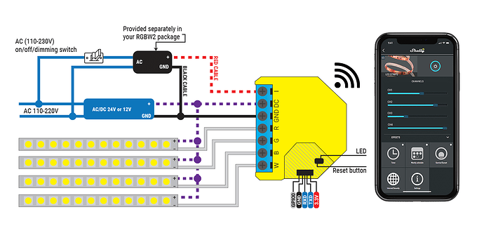

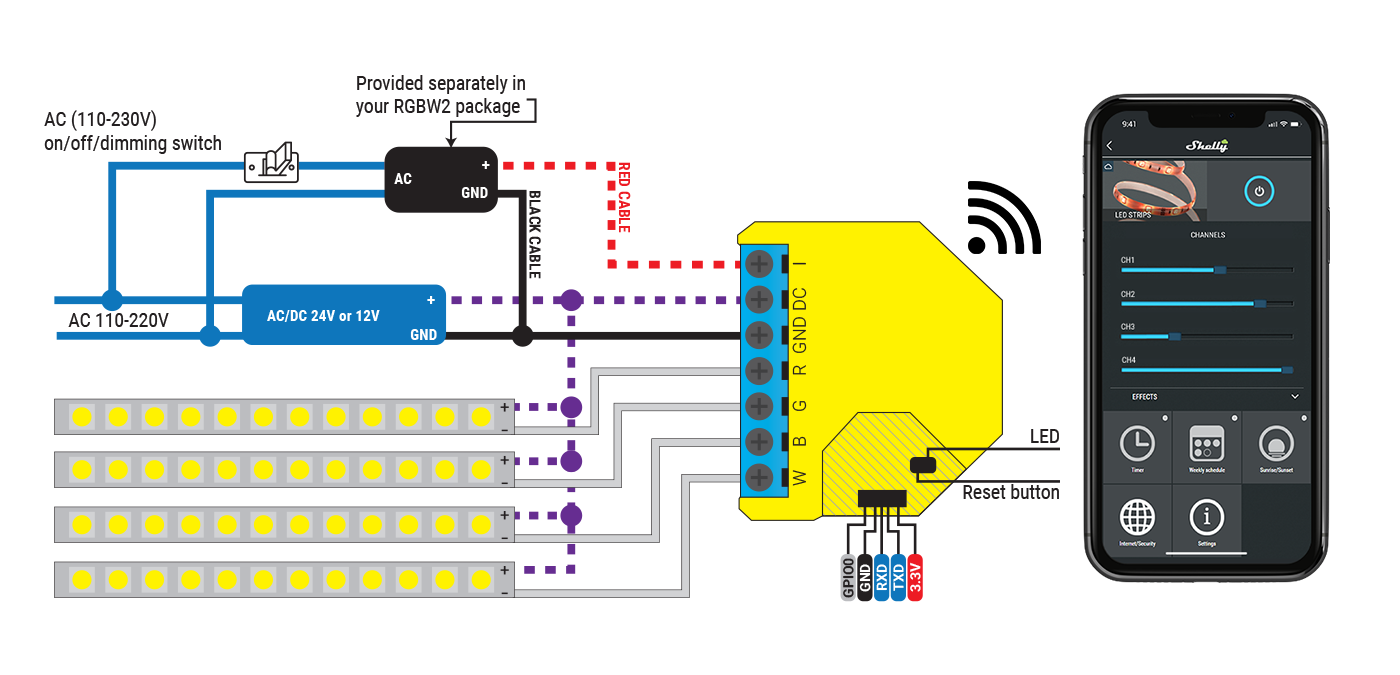

What is wrong with Shelly RGBW2 approach (except missing zigbee) ?
sorry I didn’t read the whole conversation.
actually only my the 2nd option assumes detached switches. But I understand the first and the third must not fit your requirements.
Good you find the way working for you.
Almost nothing, this is the best suggestion so far. Two things holding me back:
  1. As you said, it’s not Zigbee
  2. It doesn’t have separate channels for CW and WW. For the strips that only have CW and WW (no RGB), I could possibly cheat that through other channels
It’s not even cheating. You have 4 channels, use them as you want.
You might want to have a look at Shelly Plus RGBW PM as well…
Both can be flashed with esphome if stock Shelly setup doesn’t fit for some reason.
