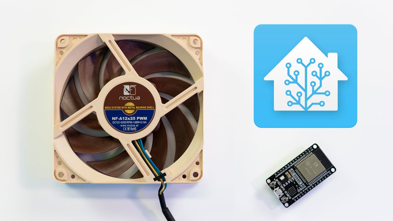

Slightly different solution- but someone has an ESP-based method for this.
Perhaps a 5v fan would remove the need for a step down transformer and simplify things further.
