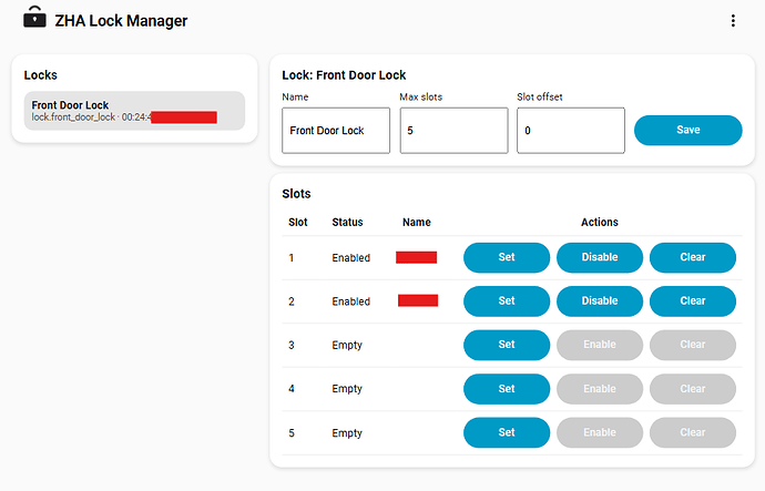

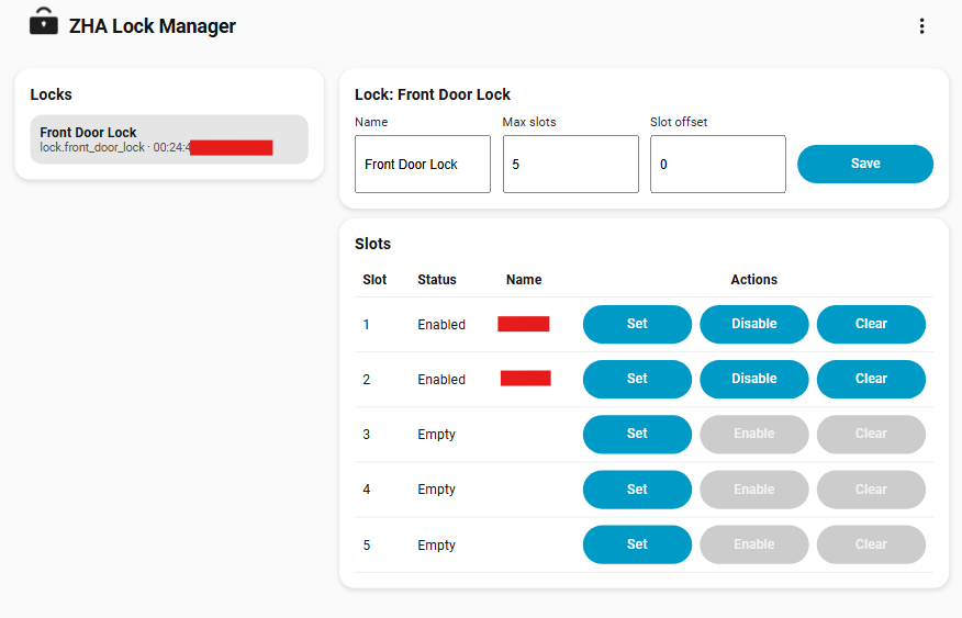

I recently put together a new option for those of you managing Zigbee locks through ZHA: ZHA Lock Manager.
It takes a slightly different approach compared to the project here:
  • Instead of relying on helpers, automations, or a static dashboard, it provides a dedicated sidebar panel that updates dynamically.
  • You can change the number of slots you manage later on, rather than being locked to the original setup.
  • It includes an optional Alarmo integration, so keypad unlocks can automatically disarm your alarm system.
If you already use ZHA, the integration installs via HACS and is fairly lightweight to get started with. Just another option for folks who want a more direct way to handle lock code management.
Screenshot Preview
Here’s what the side panel looks like in Home Assistant:

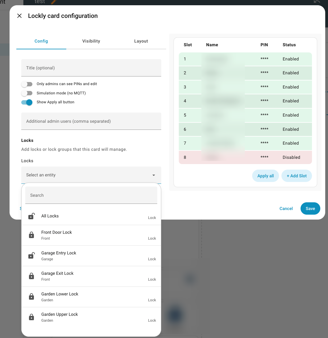

Hey there. I created a custom integration specifically for Z2M locks. It’s very new, but I’m using it reliably in my production setup. Try it out and let me know what you think.

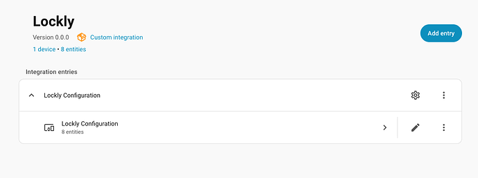

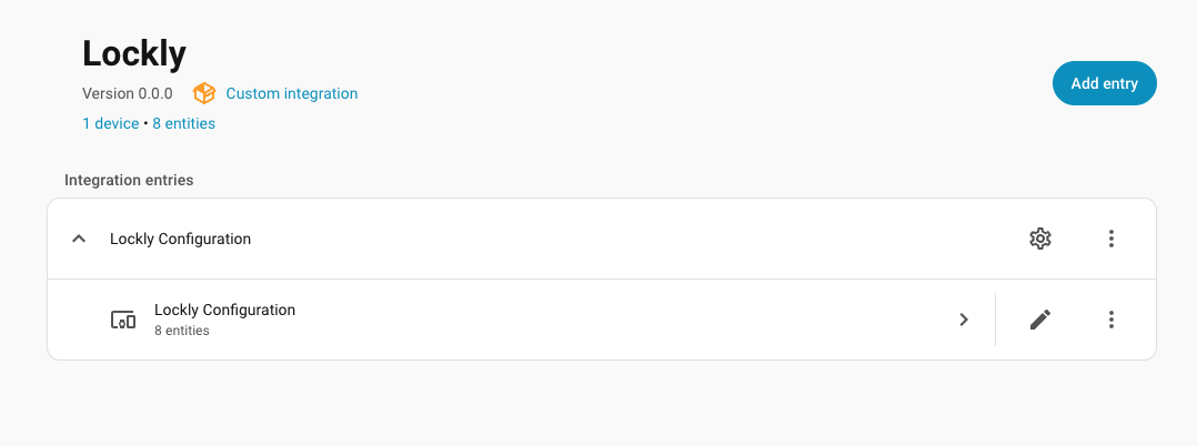

Hi @bharat, complete noob here, I’m six months in after years on Hubitat & Vera. Have 2 yale locks on HA and installed Lockly via the custom repository on HACS.

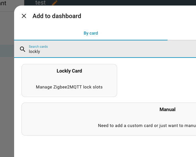

The integration is live on the configured page, but red flag 1 is that the install shows no icon and V0.0.0? And second red flag when i try and find the card to add to a test page it’s doesn’t show up in the search. Have i screwed up the download?
Then would really appreciate a bit more on how to set up the entries within the app itself…
I have 2 yale assure zigbee locks set up via zigbee2mqtt which sounds similar to your setup so it has to be possible!!
Cheers (from down under)
Mike
Hey @mrudman! You’re on the right track… thanks for trying this out.
The README says that you can access it via HACS, but the reality is that you can’t yet (until they approve my brands PR which I’ve been waiting on for 2 weeks…)
If you installed it by doing the “custom repository” approach in HACS then you’ll see that the version is v.0.0.0 – that’s fine. It’s just a placeholder for “dev version”.
Can you send screenshots of what you’ve got in the Settings → Devices & Services → Lockly page? You should have at least one configuration entry there.
As long as you have a config entry there then you’re in good shape. Go to any dashboard, go into edit mode, and search for “lockly”. You should see this:
Add the Lockly card and you should see an editor like this:
at the bottom left you can add locks from the dropdown list from your available locks. Pick a few locks and you should be all set. If you don’t see
