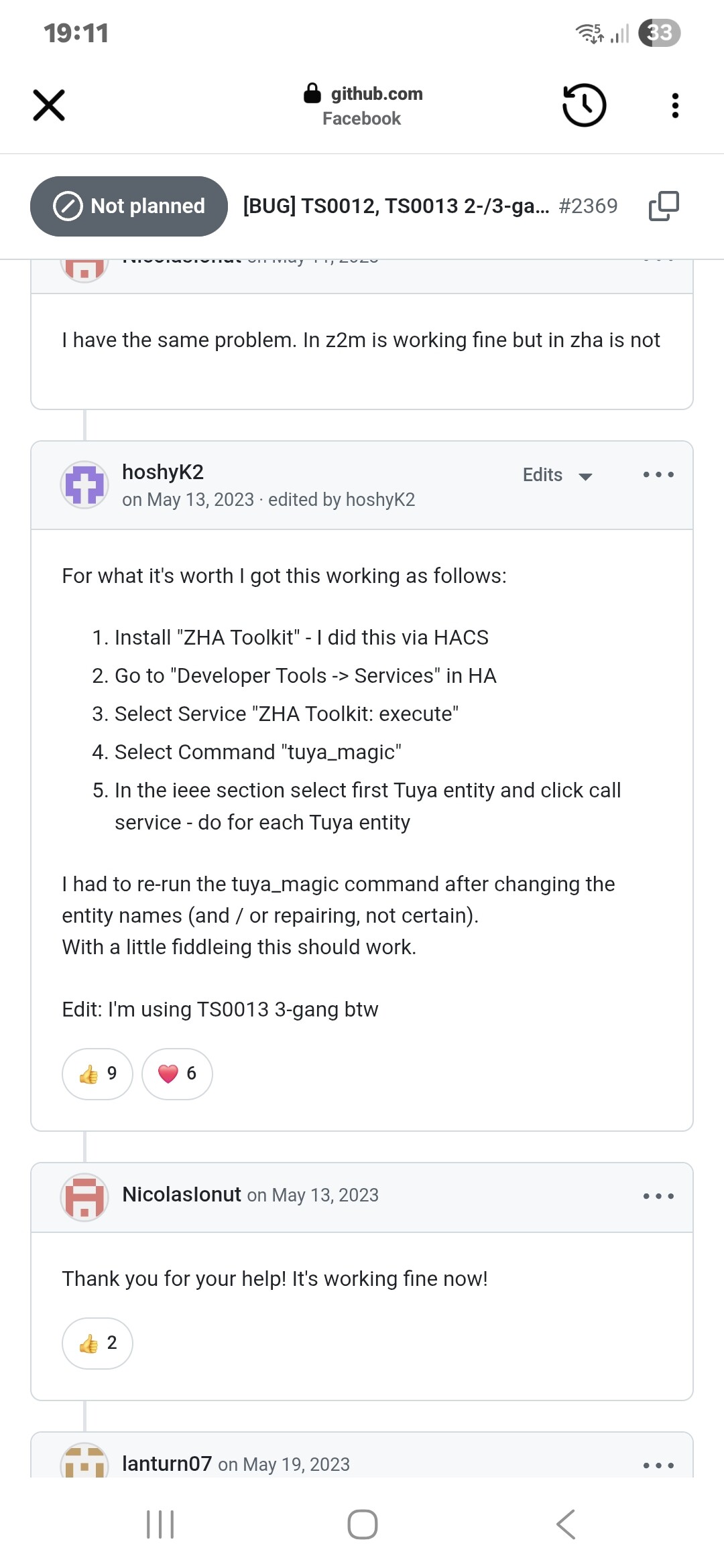

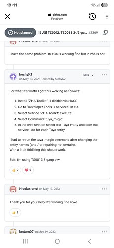

For anyone ending up here, this was supposed to be fixed since 2023, but it isn’t I guess. After digging some more, I found this solution that worked for me:
