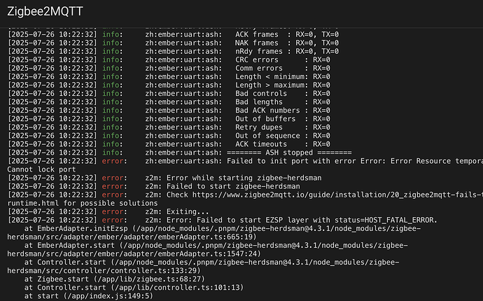

Hi there,
I’ve an Home Assistant Yellow with Zigbee controller integrated. I’m trying to perform the setup actions suggested here but I’m still stuck… can you help me guys?
Thanks a lot
HOST_FATAL_ERROR usually means some other integrations is using the serial port. Check if Zigbee Home Automation (ZHA) is running or enabled.
