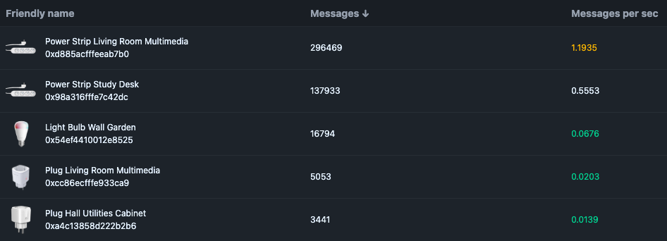

Unfortunately I don’t have the stats before acFrequency and apparentPower reporting interval configurations. But these power strips are still the most talkative devices in my network.
I’m not sure if the linkquality can be configured the same way though. I was not able to find it in any of the endpoints…
