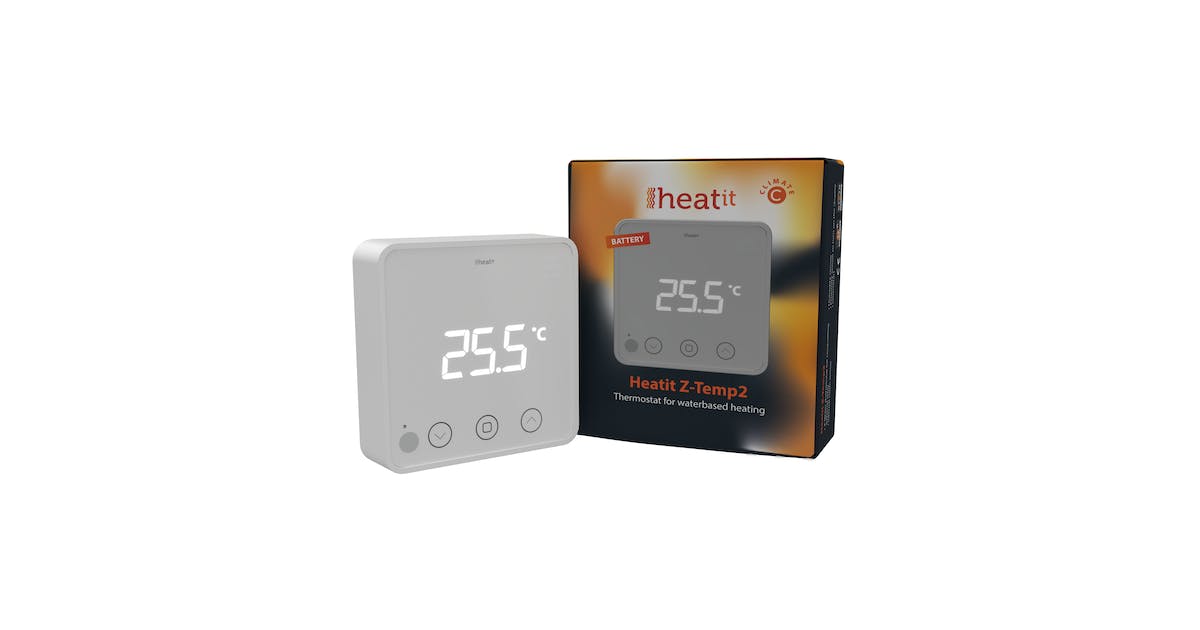

As usual, after asking I find a solution:
"Heatit Z-Temp may be associated with the Heatit ZM Single Relay or another Z-Wave relay in order to control many types of heating solutions. "
Which is exactly what I’m after - but I’d so much rather prefer it in Zigbee, mainly because the current system is Zigbee, and Z-Wave is much more expensive. For 9 rooms in the house, the Heatit solution needs a thermostat + a relay, it comes up to nearly €1500 :frowning:
