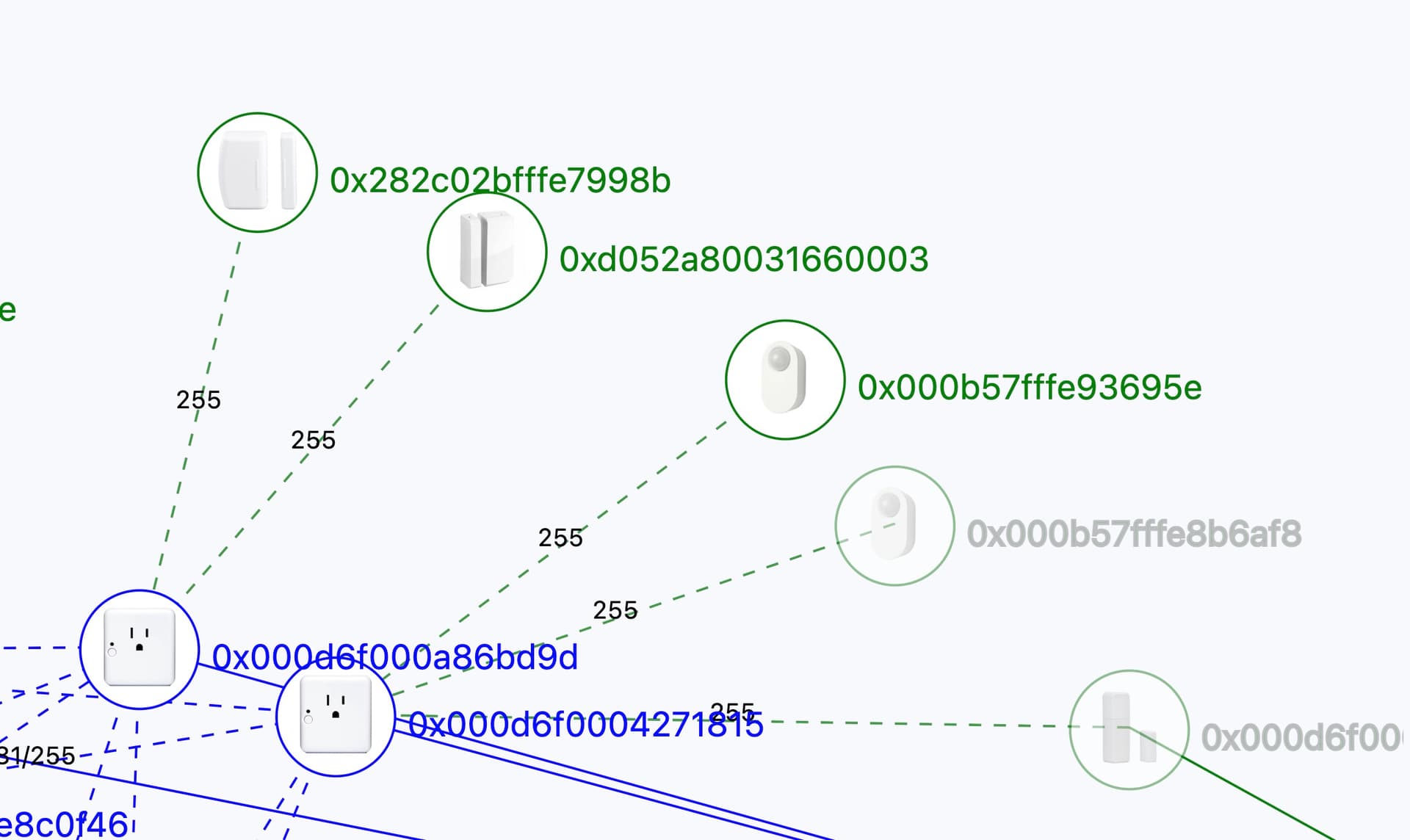

LQI is often not a very useful metric. A value of 255 for LQI on quite a number of devices means the manufacturer’s firmware is not even trying to report a value and is just setting it to 255.
In picture below, these two Centralite switches always report LQI values of 255 to devices they are routing for. They are rather old Zigbee devices however have been doing a very good job of routing for many years, but none of their firmware versions has ever reported a LQI value other than 255.
