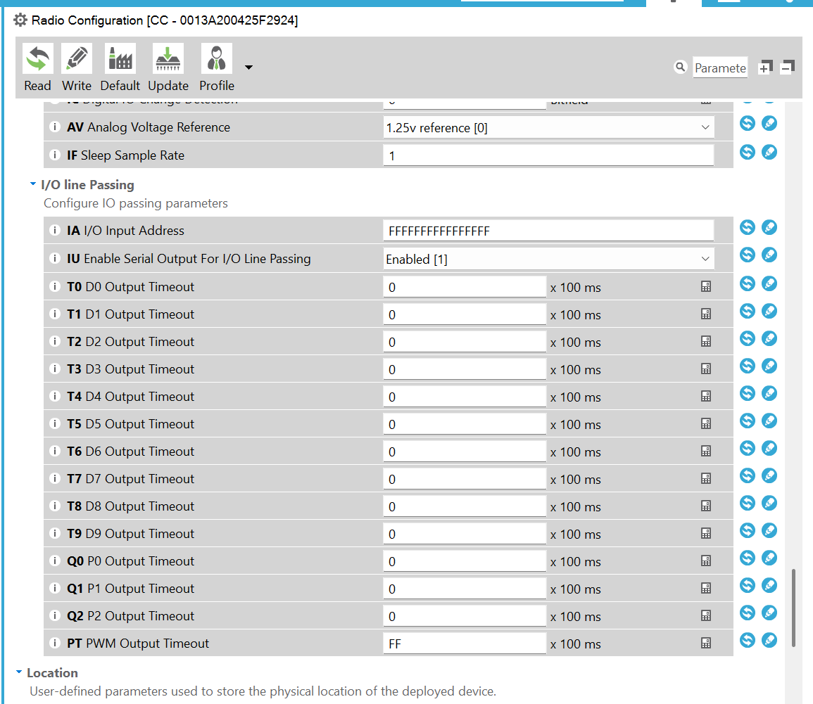

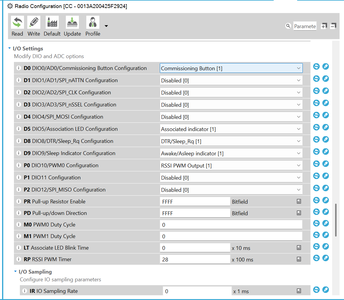

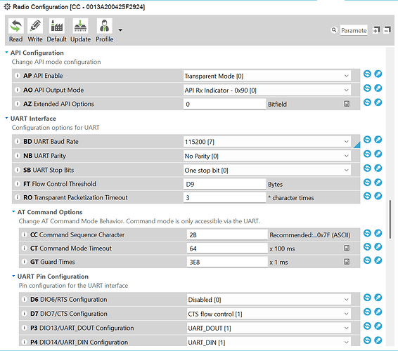

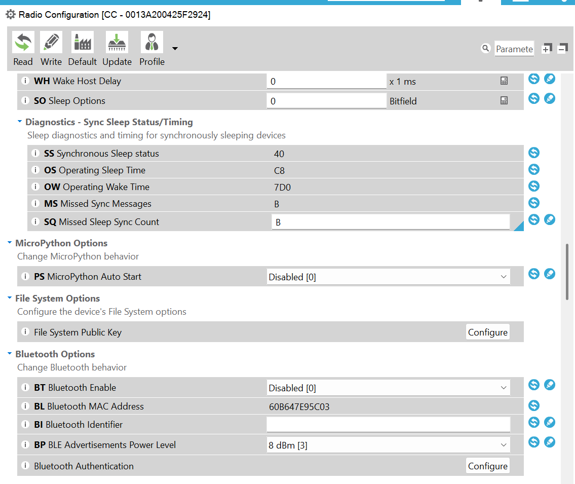

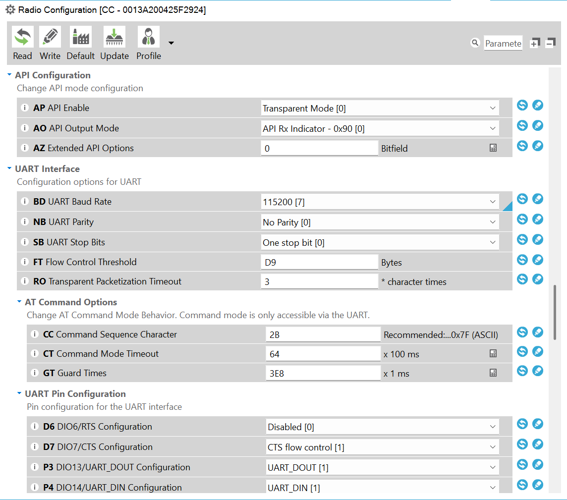

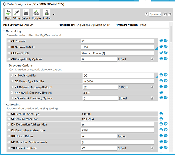

I have also attached the receiver configuration image for your reference.
Could you please help me understand whether this issue is related to network capacity, receiver configuration, antenna selection, or any other limitation in the setup?
