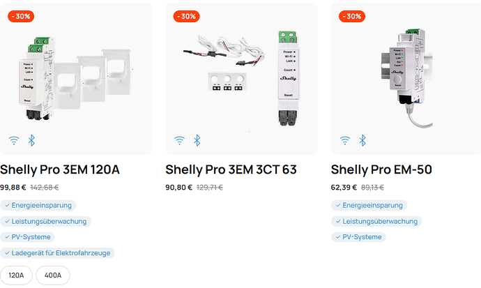

Apparently the Shelly Pro 3EM 3CT 63 has the same style “clamp” as the Zemismart. But for some reason it is not marked as Zero-feed-in device :thinking:
Why should an energy meter be marked as “zero-feed-in” device? That’s like as usefulless as marking an electric vehicle as nicotine free :person_shrugging:

See the screensot. The middle device is not tagged like the others, although it’s supposed to do the same job.
CT clamps can not be run safely in an open circuit without a burden transistor, which maybe are missing in that product.
If you read the specs, you see they are same for both PRO 3EM models, only clamps are different. Tagged or not.
And nothing is missing.
While the non-contact power/energy meters contain current transformers they already come with all necessary circuit - otherwise they would only be current meters :warning:
Translation gone wrong? A non-contact power/energy meter doesn’t/can’t interfere with the power feed :person_shrugging:
Not really. Google assisted translator doesn’t give any hint to “zero-feed”:

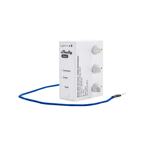

There is one more model available. It resembles the zemismart most:
Regarding zero-feed-in, I would consult Shelly support. Maybe it has something to do with resolution/precision/frequency of measurement reporting. Maybe it’s about modbus protocol some of these devices boast of, while others not etc. Just guessing. The Zero-feed-in requires pretty frequent measurements especially around 0.
Some PV inverter support zero injection/feed-in. For this to work they need to know how much power from the grid is import/exported which is usually done with the help of a power meter (sometimes only a ct) that is connected to the inverter. :electric_plug:
You need to consult ■■■ ■■■■■■ of your PV system to find out which power meters are actually supported that can be connected so the inverter can do do zero feed in (only produce as much AC power as requested locally) :sunny:
While technically possible, I seriously doubt that some PV inverter out of the box can use Shelly as meter for it’s zero-export feature.
My guess to the zero-feed was like the open circuit warning in the safety section here.
Makes zero (:zero:) sense ■■■■■■ :warning:

Great info. Thanks. Meanwhile I installed a Shelly 3EM Pro. Unfortunately the clamps would have been to large for my setup anyways.
The form factor of the original SPM02 is a big plus.
EDIT:
Just saw the Bituo Technik one has the same compact form factor as the SPM02 :ok_hand:
