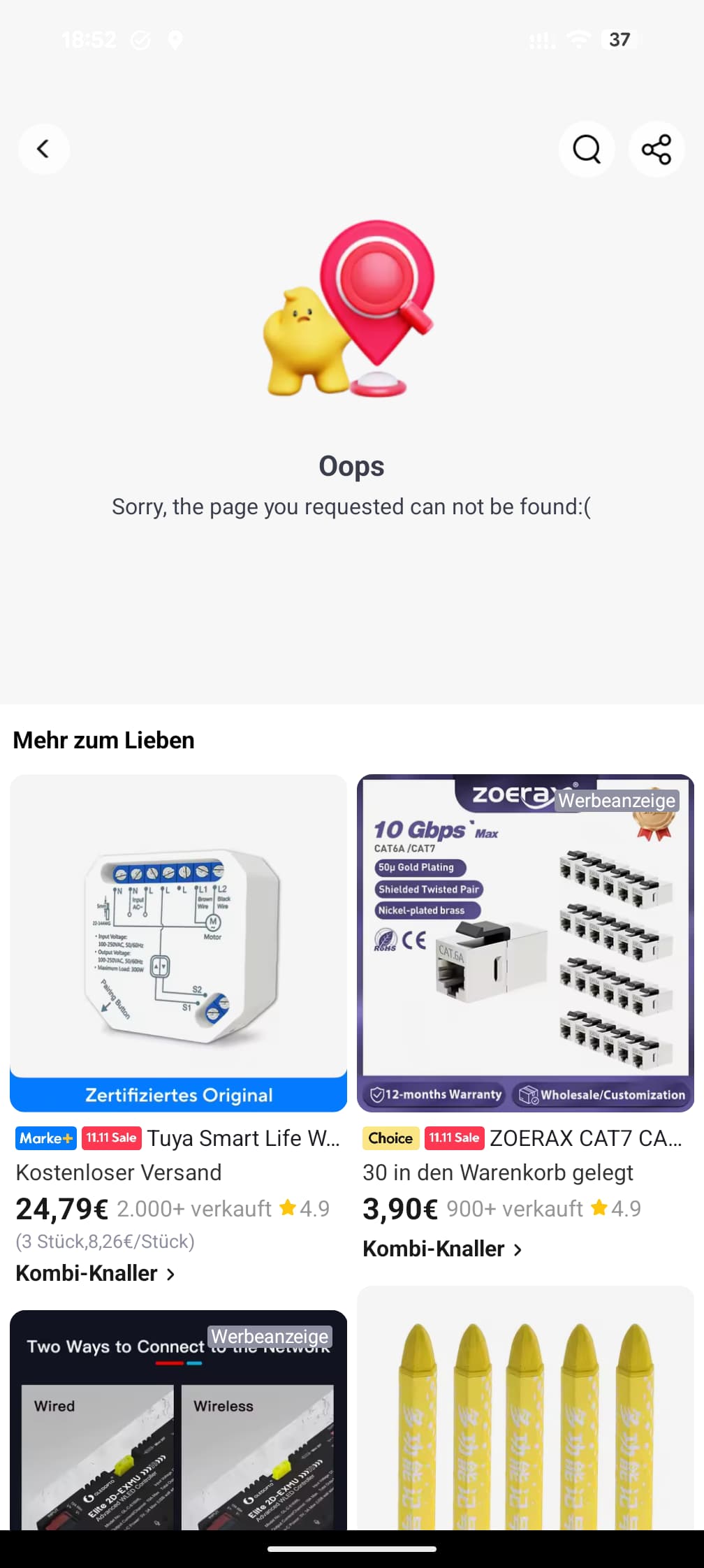

Anyone can recomend me zigbee thermostat with cooling/heating mode?
This one is gone
