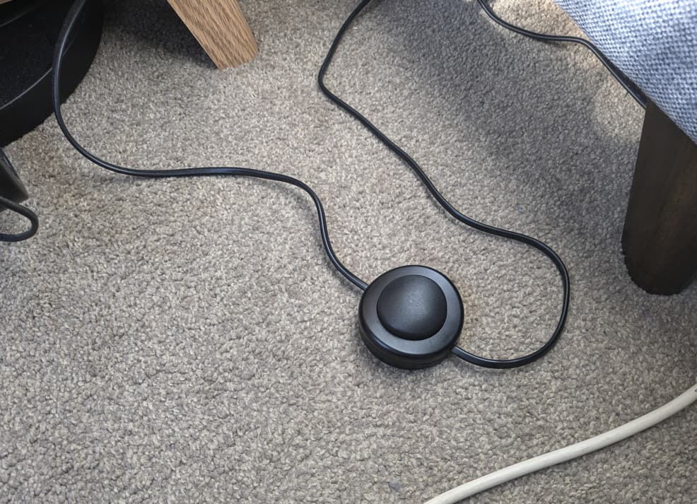

I’m looking for the solution to a similar problem. I have a floor light with an inline switch, the type that you stand on to turn on and off:
I fitted an Aqara Zigbee bulb to it and would like to make the switch smart so that other family members can turn it on/off via the switch without HA losing access to the bulb.
The switch body doesn’t look big enough to fit something like a Sonoff ZBMINIR2 inside so I’m a bit stumped.
