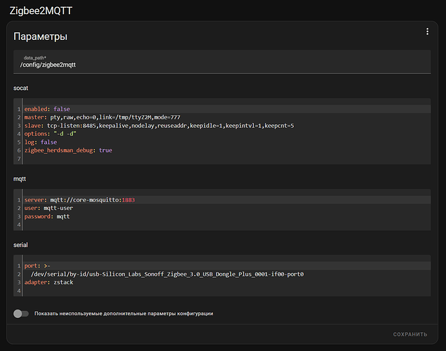

Lately I have made so many changes that I can hardly list all the actions accurately, but the general procedure was as follows:
As a result, I get several different errors:
  1. SRSP - SYS - ping after 6000ms (when I change the port to /dev/ttyUSB0)
  2. SRSP - SYS - getExtAddr after 6000ms
  3. TypeError: Cannot read properties of null (reading ‘length’) (actual for now)
There was also a "Failed to call 'Frontend' 'stop' (TypeError: Cannot read property 'clients' of null..." error, but I don’t remember what parameters were used at the time of display…

Where you have ‘core-mosquitto’ try the dedicated IP of the machine your coordinator is connected too mqtt://ip_address:1883
After I change the mqtt address from 172.17.0.1 to the actual haos address, I can use it

It turned out that there are adapters that are not supported by the plugin due to the architecture.
This is strange.
My issue on zigbee2mqtt github
Several different errors about "502 Bad Gateway" · Issue #16047 · Koenkk/zigbee2mqtt · GitHub
I solved the problem by purchasing another adapter. Dongle-E instead of Dongle-P.
And replace “ezsp” instead of “zstack” in “adapter” config respectively.
