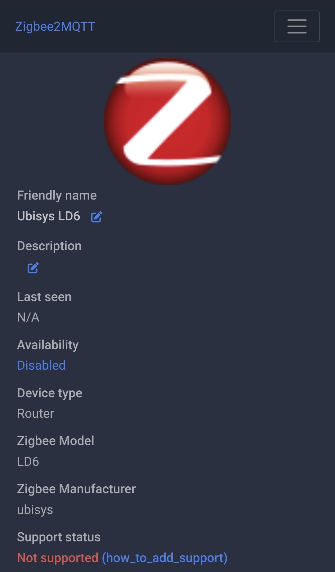

Any news here? I also have the LD6. z2m seems to not support this device yet. Has anybody taken on creating a support for it yet?
See this discussion for activities into supporting it for z2m: Support of Ubisys LD6 · Koenkk/zigbee2mqtt · Discussion #28614 · GitHub
