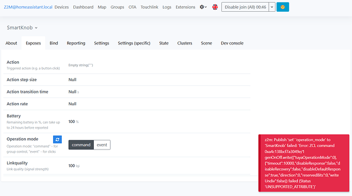

Any idea why I’m getting a ZCL command error (Status ‘UNSUPPORTED_ATTRIBUTE’) when I try a normal turn of the knob with your blueprint?
Only the single click works. It’s set to command and using the correct MQTT Topic (clicking works)
I just tested it again by manually subscribing to the MQTT-Topic.
If it is indeed supposed to work by the device itself then it at least does not seem supported by Z2M.

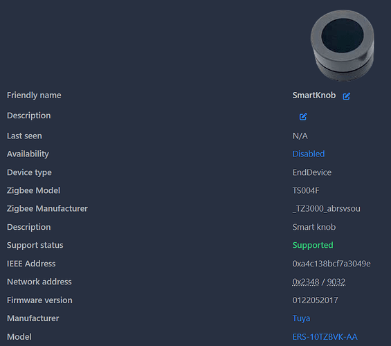

Can you check if you have the exact same device like this:
Looks to me like the payload you get through MQTT is different then for mine…
Thanks for the reply. Pretty much apart from ‘Zigbee manufacturer’
