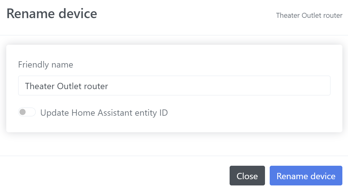

I also noticed that when I change the names of the devices in Z2M it is not changing them in HA, even though I clicked the toggle that says it does it.
I suspect these are related… any idea how to fix?

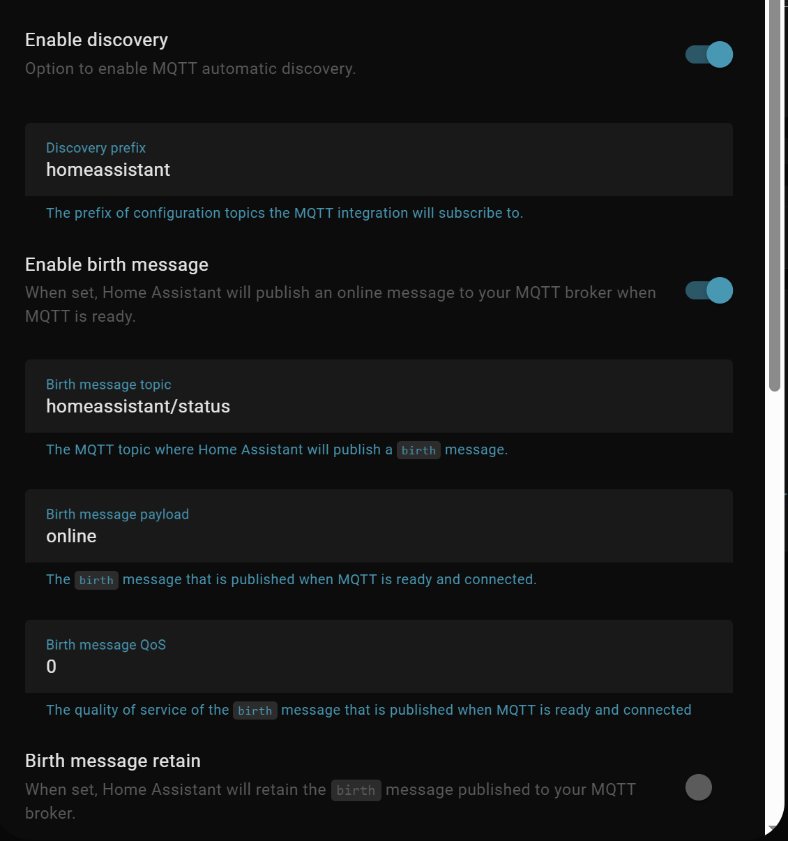

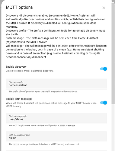

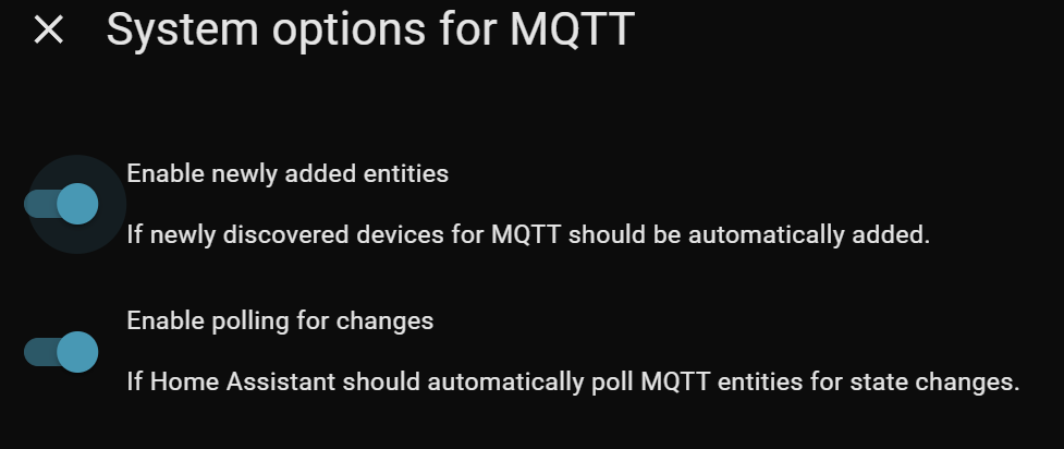

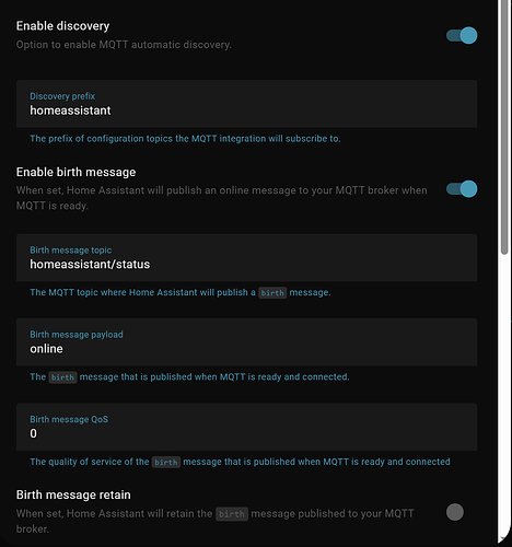

How are your mqtt options set ?
Thanks for helping. Completely new/fresh install (HA, MQTT, etc) ~ 2 months ago - I never had HA before. Same settings since day 1, and it was working fine until a day or so ago. I added another device last night, that has not sync’d either. So about a week ago I added 4 outlets, they sync. Two days ago I added an Osram LED strip, last night I added an Aqara motion – neither of these sync to HA.
