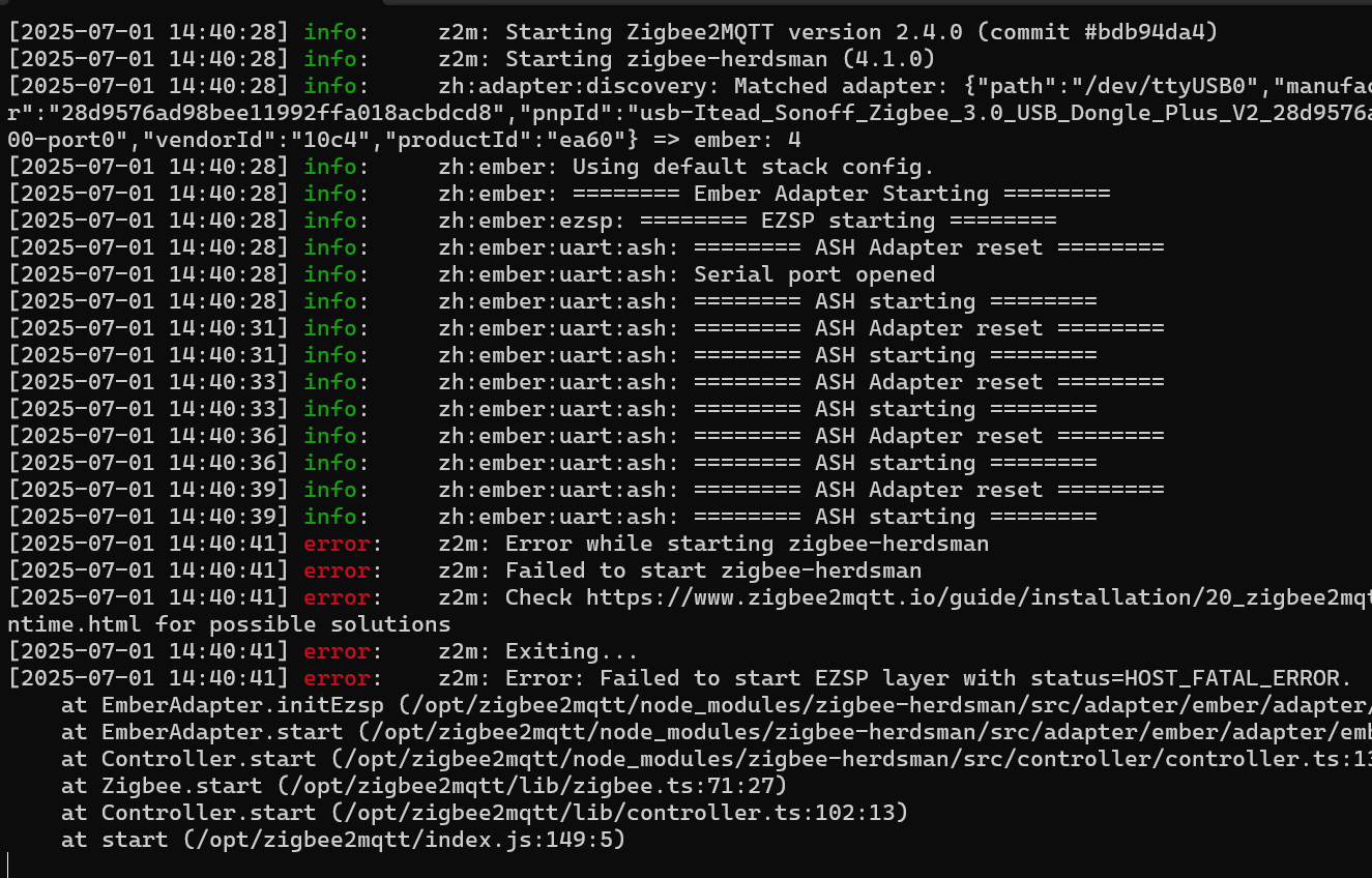

i have been getting this error when trying to on board the zigbee2mqtt but i keep getting this error.
That error tells you to go to Zigbee2MQTT fails to start/crashes runtime | Zigbee2MQTT for a full troubleshooting page.
Most common cause is that ZHA is enabled and not letting Z2MQTT speak to your coordinator.
I went to the troubleshooting page, couldn’t find anything that could help me and the ZHA is not enabled. I’m also running this on a raspberry pi, I don’t know if thats useful to not, I’m new to this
Maybe this thread might help:
A few questions:
- What device and HA install version are you using?
- Do you have a Mosquitto Broker installed?
Please share your Z2M config

Raspberry pi 5

What error do you get ?
No error, but when i open web ui it always opens the onboarding page.
That is easily solved. Open /config/zigbee2mqtt/configuration.yaml and delete the line
onboarding: true
That line is not in my config
What does the mqtt log say ? Your user and password are empty, probably Zigbee2MQTT can’t login to the broker.
If you use the mqtt add-on, it does not accept anonymous logins, you
- either create a mqtt user in ha
- or create a user in the mqtt add-on
and set these credentials in the Zigbee2MQTT add-on
Now it works. With this config:
