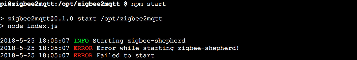

Trying to install zigbee2mqtt on an RPI 3. I’m using the steps pointed out in ‘running the bridge’.
All went well until step 5. After completing this step I receive the following error.
What could cause this problem?
@doubleUS, When I had this issue, it was mostly had to do with the sniffer. If the system isn’t seeing it, will come up with that problem.
What’s the output of ls /dev/tty*?
Regards
ls -l /dev/ttyACM0
Gives the following output:
crw-rw---- 1 root dialout 166, 0 mei 25 18:03 /dev/ttyACM0
So, the Pi ‘sees’ the sniffer.
Hmm, looks like you’re right. After disconnected the sniffer and re-inserted it, zigbee2mqtt started again.
Thanks, @Odianosen25!
