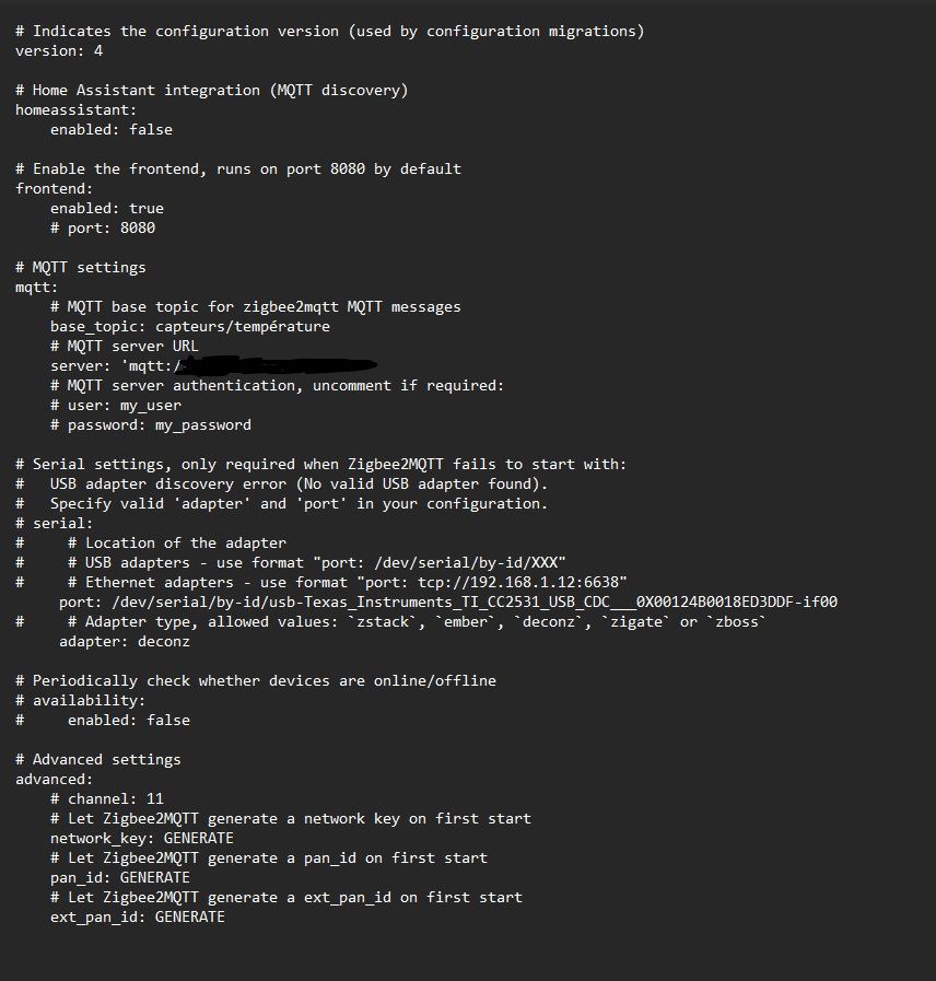

Please don’t use pictures, post the code formatted correctly. You have not shared details about your installation and you are showing the wrong configuration.yaml (notice the one I asked about is located in the zigbee2mqtt folder).
I don’t have any configuration.yaml in the zigbee2MQTT folder

That’s the only config file i got

You haven’t defined a mqtt server, you have homeassistant set to false, you have a CC2531 adapter and defined that as a Deconz adapter.
I suggest you start over, and read the installation instructions carefully.
