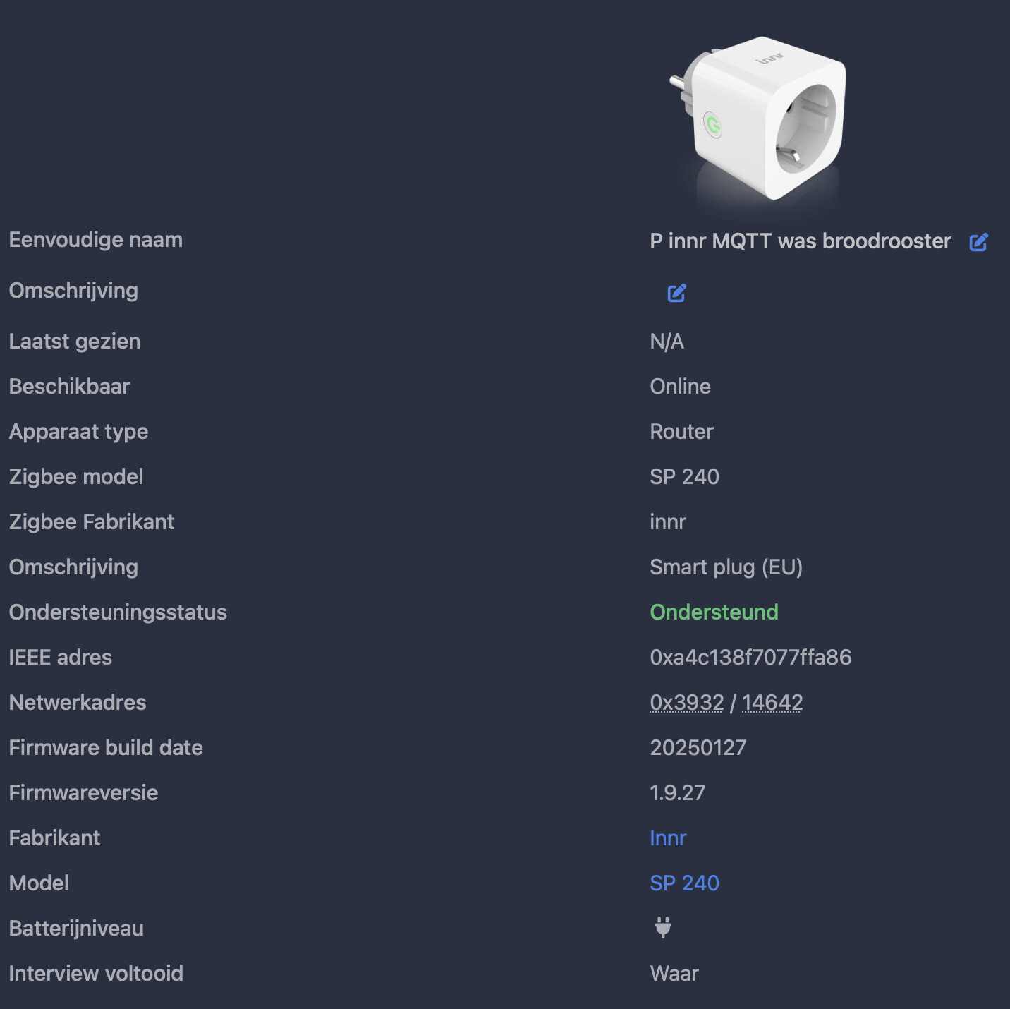

I too have a device that has “Last seen: N/A”. I have the Z2M add-on in HA.
The device can be controlled from the Z2M add-on, but pressing the on/off button on the device itself doesn’t change the state in the Z2M dashboard, let alone in HA.
The device is an innr SP240 smart plug, I just installed firmware 1.9.27 with firmware build date 20250127:
Is this state reporting malfunction due to the “last seen: N/A” issue?
I have not tried re-pairing the device yet.
